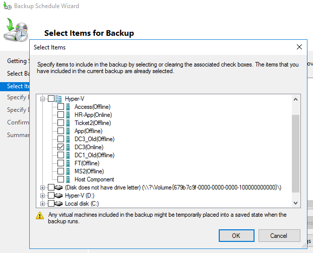

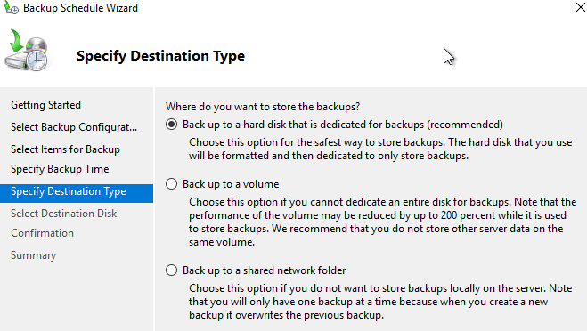

Hello. I have several servers with Windows Server 2016 and Hyper-V installed. Each has several virtual machines with Windows Server. Each virtual machine has a replica of another physical server and a backup of the NAS server, which is made overnight. Since some of the virtual machines are small in size, 60-120GB, I decided to make the backup of Hyper-V virtual machines on a dedicated disk on the NAS server.

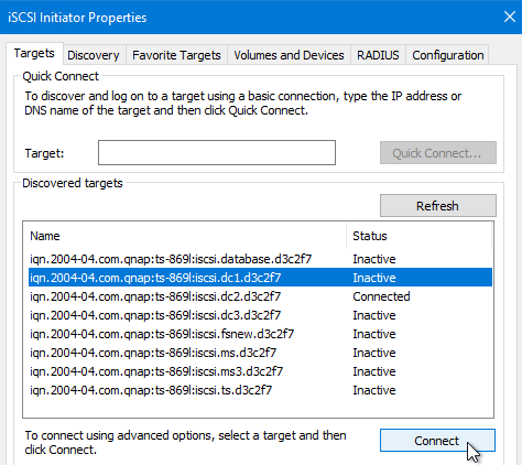

I decided to use the backup. But when I mount the iSCSI to Windows, a blue screen appears with the same error. I tried on several computers and they all crash the moment I mount the iSCSI disk.

  1. Is the failure caused by backing up the virtual machine from the Hyper-V host?
  2. Is the failure caused by backing up to a dedicated hard drive?
