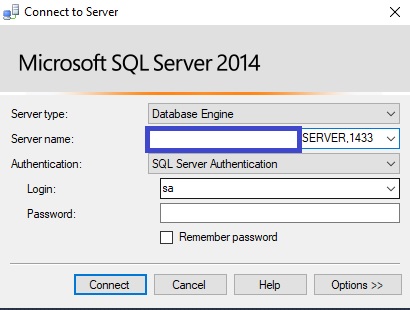

  3. Thin Thuzar Oo 5 Reputation points
    2023-01-11T08:23:25.72+00:00
    Untitled
    When you connect using Microsoft Management Studio, please type the port no 1433.
    Try Telnet command for 1433 also. In cmd.exe, type this command to check whether port 1433 is on : Telnet IPaddress or PC name 1433 (eg: Telnet 192.168.1.160 1433).
    If cmd shows black screen, the port is opening.
    please turn on Telnet Client in Win10 using Windows features on or off in Control panel.
