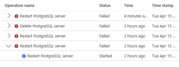

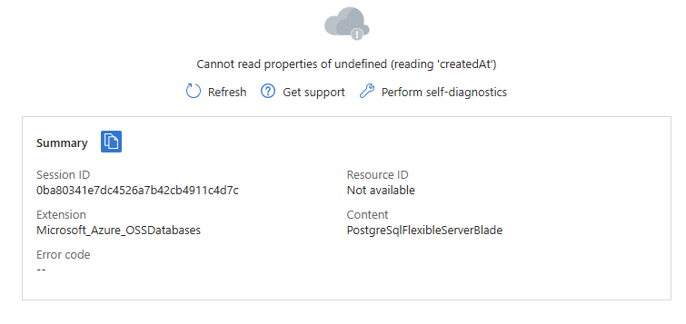

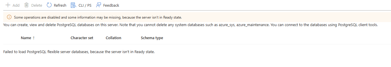

Hi. My database became unresponsive, so I did a manual restart. It has been restarting for over 3 days now.
I then tried to delete the database to re-create it. This also has not worked. I cannot manage the database, but my container app that uses the database seems to run okay.

    The server should now be up and running. Please check and confirm.
    It appears the VM was unhealthy, and to mitigate the issue, the backend team likely restarted it.

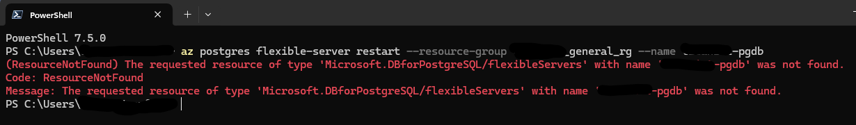

    • Sometimes, the server might need more time to complete the restart process. Wait for a few more hours and then try restarting it again using the Azure portal or Azure CLI.
    • Since the portal may not allow changes while the server is restarting, try increasing the storage via Azure CLI. Increase storage beyond 100% usage (e.g., if it was 100GB, try setting it to 120GB).
    • Check if auto-growth is enabled, Azure might be attempting to allocate more space automatically. You can check this in the Azure portal under Storage Configuration.
    If storage was increased, restart the server via Azure CLI.
    az postgres flexible-server restart --resource-group <your-resource-group> --name <your-server-name>
