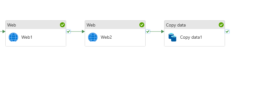

I am facing an issue where the API works from Web activity of Adf pipeline but doesn't work from Rest source of Copy data activity. It was working initially and stopped.
Same API works from web activity and postman.
My API works from Web activity but doesn't work from the Rest Data source of Copy Activity.

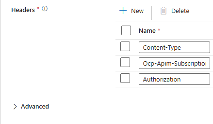

It was working initially and after a week when I tried it suddenly it fails with error 406. If I add Http Json data source adding additional headers Content type, Ocp-Apim-Subscription-Key and Authorization with Bearer token is so difficult to format it doesn't work too.

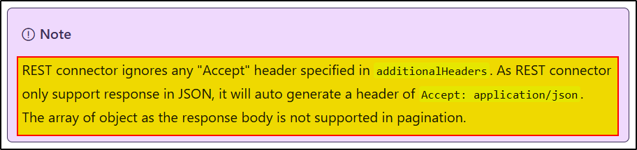

    The issue you're facing is due to the response data being in JSON-LD format (JSON for Linked Data). When using the Copy Data activity with REST source, ADF sets default headers that may not align with what the API expects in terms of content negotiation.
    Root Cause.
    ADF’s Copy Data activity sets default headers like Accept: application/json, which may not align with your API’s requirements. Since your API works in Web Activity and Postman, it's likely expecting a different Accept header—possibly for JSON-LD (application/ld+json) or another specialized format.
    For additional information, please refer: Copy and transform data from and to a REST endpoint by using Azure Data Factory

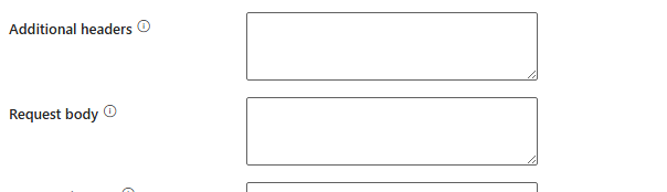

    To resolve the issue, explicitly configure the required headers in your REST dataset used in the Copy Activity. Here’s what you can try adding in the Request Headers:
    Accept: application/ld+json
    Content-Type: application/ld+json
    Authorization: Bearer <your_token>
    Ocp-Apim-Subscription-Key: <your_key>
    This will ensure that ADF requests are compatible with the API’s expected format and prevent the 406 error.
    Make sure:
    • The Authorization value is formatted exactly as: Bearer <token> (with a space).
    • Header names are correctly cased (Content-Type, not contenttype).
    • These headers match what works in Postman or Web Activity.

    If the API returns complex JSON (e.g., JSON-LD), ADF might have trouble flattening it into a tabular format. In that case, consider:
    • Using Web Activity to call the API and save the response to Blob Storage.
    • Then use Mapping Data Flow or Data Flow activity to parse and load into SQL.
