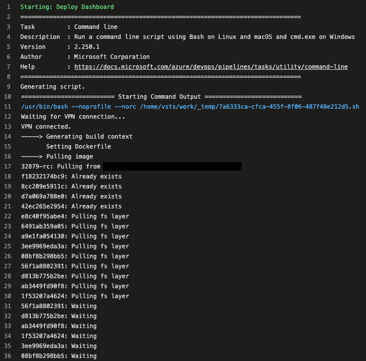

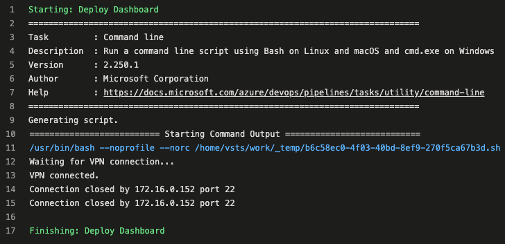

It was working fine until April 9th.
User's image Afterwards, it doesn't run anything at all.

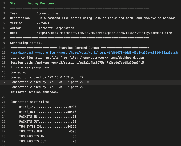

I though to myself, maybe I need to upgrade the OpenVPN to OpenVPN3. So I did:
  - stage: 'DeployToStaging'
    displayName: 'Deploy to Staging'
    condition: eq(variables['Build.SourceBranch'], 'refs/heads/main')
    jobs:
      - job: DeployDashboard
        steps:
          - task: InstallSSHKey@0
            inputs:
              knownHostsEntry: $(known_host_entry)
              sshPublicKey: $(ssh_public_key)
              sshKeySecureFile: $(ssh_private_key)
              addEntryToConfig: true
              configHostAlias: staging
              configHostName: $(dokku_staging_ip)
              configUser: $(server_user)
            env:
              PUBLIC_KEY: $(ssh_public_key)
            displayName: 'Add SSH Fingerprint'
          # Build and push Docker image
          # Needs separate step because build arguments are not supported in Docker@2 buildAndPush
          - task: Docker@2
            displayName: 'Build docker image'
            inputs:
              containerRegistry: $(containerRegistry)
              command: 'build'
              Dockerfile: './Dockerfile'
              repository: $(repository)
              arguments: $(stagingBuildArguments)
              tags: |
                $(Build.BuildId)-rc
                test
          - task: Docker@2
            displayName: 'Push docker image'
            inputs:
              command: 'push'
              tags: |
                $(Build.BuildId)-rc
                test
          # Install OpenVPN
          - script: |
              sudo mkdir -p /etc/apt/keyrings && curl -fsSL https://packages.openvpn.net/packages-repo.gpg | sudo tee /etc/apt/keyrings/openvpn.asc
              DISTRO=$(lsb_release -c -s)
              echo "deb [signed-by=/etc/apt/keyrings/openvpn.asc] https://packages.openvpn.net/openvpn3/debian $DISTRO main" | sudo tee /etc/apt/sources.list.d/openvpn-packages.list
              sudo apt-get update -y
              sudo apt-get install openvpn3 -y
            displayName: 'Install OpenVPN'
          - task: DownloadSecureFile@1
            displayName: 'Download OpenVPN Config'
            inputs:
              secureFile: 'dashboard.ovpn'
            displayName: 'Download OpenVPN Password'
            inputs:
              secureFile: 'openvpn_auth.txt'
          # Deploy
          - script: |
              # Start OpenVPN in the background and capture its PID
              cat $(ovpn_auth.secureFilePath) | openvpn3 session-start --config "$(ovpn_config.secureFilePath)"
              # Deploy
              ssh staging git:from-image dashboard $(image_name):$(Build.BuildId)-rc
              ssh staging cleanup
              ssh staging docker-direct image prune -f
              # Stop OpenVPN
              openvpn3 session-manage --config $(ovpn_config.secureFilePath) --disconnect
            displayName: 'Deploy Dashboard'
All I got was connected, but the connection is closed.
Any ideas why?
