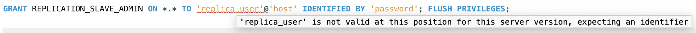

However, this results in the following MySQL error:
Error Code: 1227. Access denied; you need (at least one of) the SUPER or REPLICATION_SLAVE_ADMIN privilege(s) for this operation
We believe this indicates that the replica server requires elevated privileges on the Azure source, which are currently not available due to platform restrictions.
