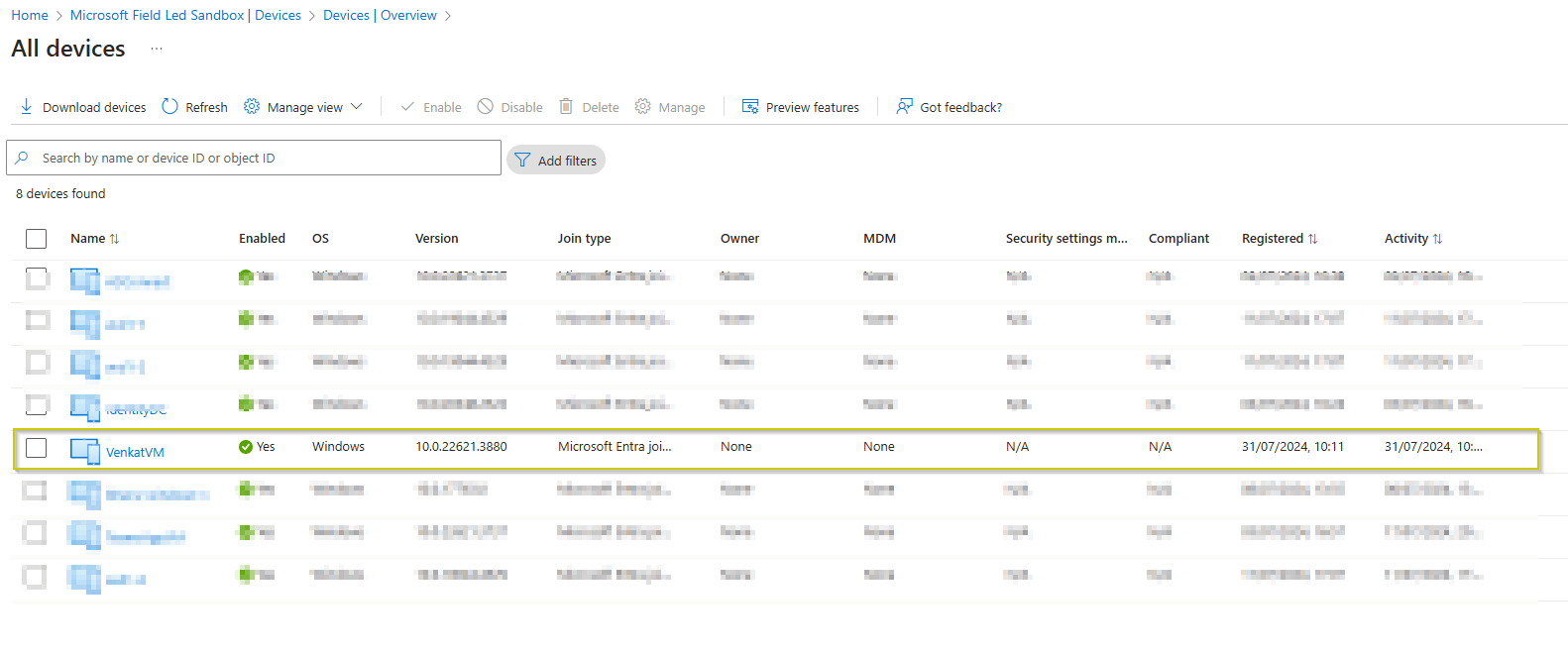

    1. Verify the Device Joining status by navigating to Entra AD > Devices.

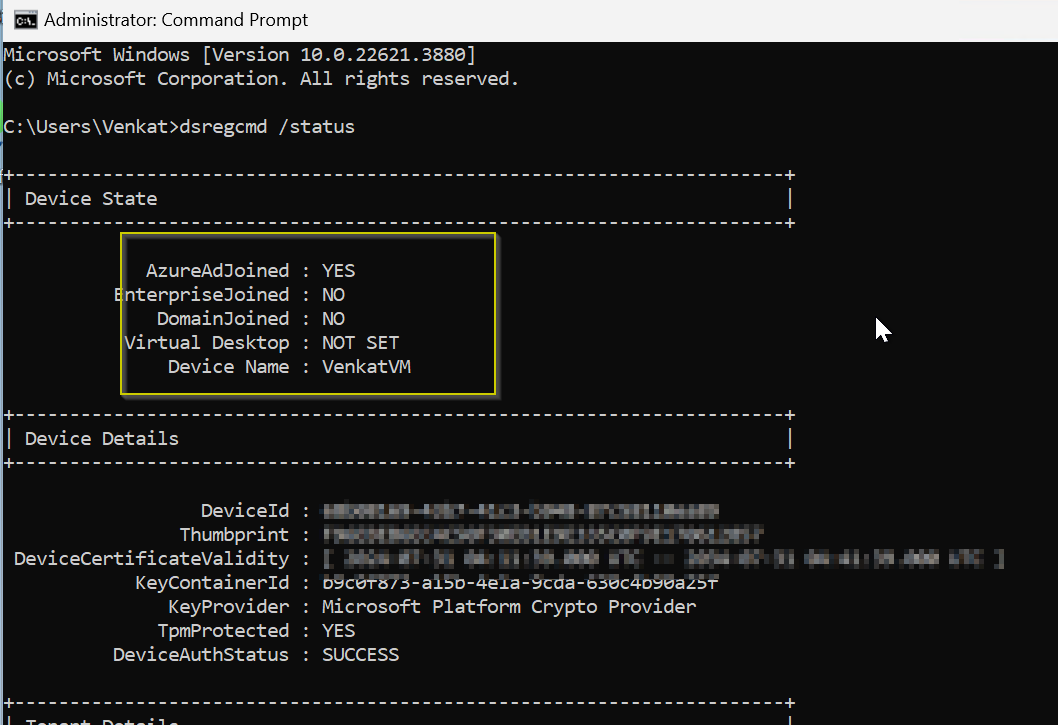

    enter image description here5. Check the Azure AD join status on the VM by running the dsregcmd /status
