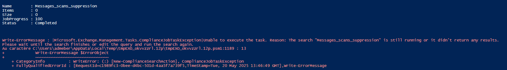

Hello folks !
For security reason, I have to delete emails from a mailbox time to time.
Therefore, I created this script below in Powershell to be run every day with a scheduled task.
Everything works fine, despite numerous problem due to lack of rights that I resolved, except when it comes to delete those emails.
It throws me this error :
Write-ErrorMessage : |Microsoft.Exchange.Management.Tasks.ComplianceJobTaskException|Unable to execute the task. Reason: The search "Messages_scans_suppression" is still running or it didn't return
any results. Please wait until the search finishes or edit the query and run the search again.
Au caractère C:\Users\XXX\AppData\Local\Temp\tmpEXO_ltltarxx.uae\tmpEXO_ltltarxx.uae.psm1:1189 : 13
+             Write-ErrorMessage $ErrorObject
    + CategoryInfo          : WriteError: (:) [New-ComplianceSearchAction], ComplianceJobTaskException
    + FullyQualifiedErrorId : [RequestId=8ace4e0d-9213-86c8-a828-3e35111e4532,TimeStamp=Thu, 24 Apr 2025 13:59:16 GMT],Write-ErrorMessage

Here is the full console output :
attente execution job
Items       : 0
JobProgress : 0
Status      : Starting
Items       : 0
JobProgress : 0
Status      : Starting
Items       : 0
JobProgress : 0
Status      : Starting
Items       : 0
JobProgress : 0
Status      : Starting
Items       : 0
JobProgress : 0
Status      : Starting
Items       : 0
JobProgress : 0
Status      : Starting
Items       : 0
JobProgress : 0
Status      : Starting
Items       : 0
JobProgress : 100
Status      : Completed
Suppression

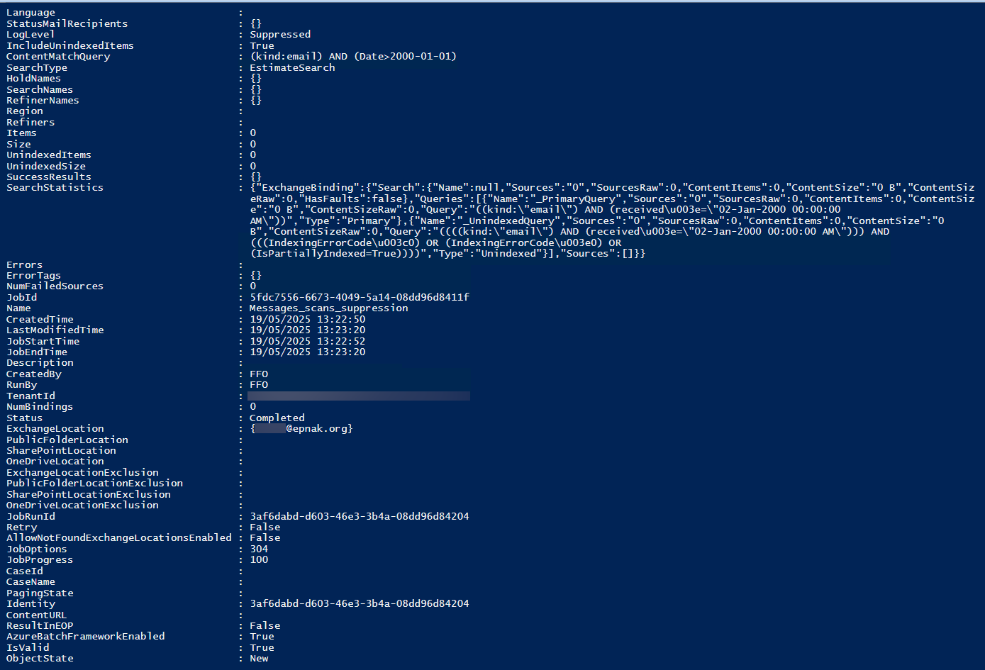

Language                              :
StatusMailRecipients                  : {}
LogLevel                              : Suppressed
IncludeUnindexedItems                 : True
ContentMatchQuery                     : kind:email
SearchType                            : EstimateSearch
HoldNames                             : {}
SearchNames                           : {}
RefinerNames                          : {}
Region                                :
Refiners                              :
Items                                 : 0
UnindexedItems                        : 0
UnindexedSize                         : 0
SuccessResults                        : {}
SearchStatistics                      : {"ExchangeBinding":{"Search":{"Name":null,"Sources":"0","SourcesRaw":0,"ContentItems":0,"ContentSize":"0
                                        B","ContentSizeRaw":0,"HasFaults":false},"Queries":[{"Name":"_PrimaryQuery","Sources":"0","SourcesRaw":0,"ContentItems":0,"ContentSize":"0
                                        B","ContentSizeRaw":0,"Query":"kind:\"email\"","Type":"Primary"},{"Name":"_UnindexedQuery","Sources":"0","SourcesRaw":0,"ContentItems":0,"ContentSize":"0
                                        B","ContentSizeRaw":0,"Query":"((kind:\"email\") AND (((IndexingErrorCode\u003c0) OR (IndexingErrorCode\u003e0) OR
                                        (IsPartiallyIndexed=True))))","Type":"Unindexed"}],"Sources":[]}}
Errors                                :
ErrorTags                             : {}
NumFailedSources                      : 0
JobId                                 : f5e34838-2064-4e41-dffb-08dd8338047b
CreatedTime                           : 24/04/2025 13:57:57
LastModifiedTime                      : 24/04/2025 13:58:51
JobStartTime                          : 24/04/2025 13:57:59
JobEndTime                            : 24/04/2025 13:58:51
Description                           :
CreatedBy                             : FFO
RunBy                                 : FFO
TenantId                              : XXX
NumBindings                           : 0
Status                                : Completed
ExchangeLocation                      : {******@XXX.org}
PublicFolderLocation                  :
SharePointLocation                    :
OneDriveLocation                      :
ExchangeLocationExclusion             :
PublicFolderLocationExclusion         :
SharePointLocationExclusion           :
OneDriveLocationExclusion             :
JobRunId                              : 3600ac93-c5e3-4e2d-e4d3-08dd833805e3
Retry                                 : False
AllowNotFoundExchangeLocationsEnabled : False
JobOptions                            : 304
JobProgress                           : 100
CaseId                                :
CaseName                              :
PagingState                           :
Identity                              : 3600ac93-c5e3-4e2d-e4d3-08dd833805e3
ContentURL                            :
ResultInEOP                           : False
AzureBatchFrameworkEnabled            : True
IsValid                               : True
ObjectState                           : New
0

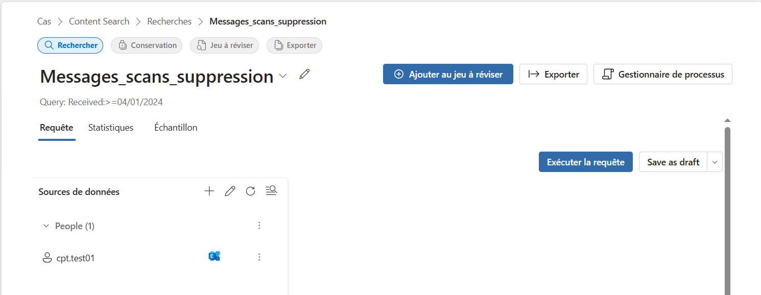

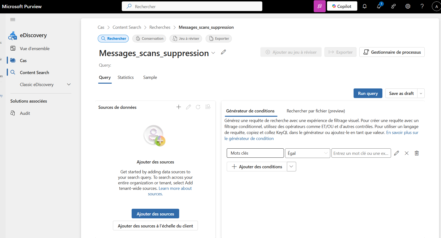

In order to resolve this issue, I went to Purview to see if my compliance search was created. It is.
But, when I look up for details, I don't see the "target" as specified in my script with the argument "-ExchangeLocation ******@XXX.org" :
Any help would be appreciated :)

    Thanks for sharing the script and output. The error you are encountering indicates that the compliance search you created is still running or did not return any results, which is why the purge action fails with the following message:
    "The search is still running or it didn't return any results. Please wait until the search finishes or edit the query and run the search again."
    In your case, the search did complete, but since it found 0 items, there was nothing to delete.
