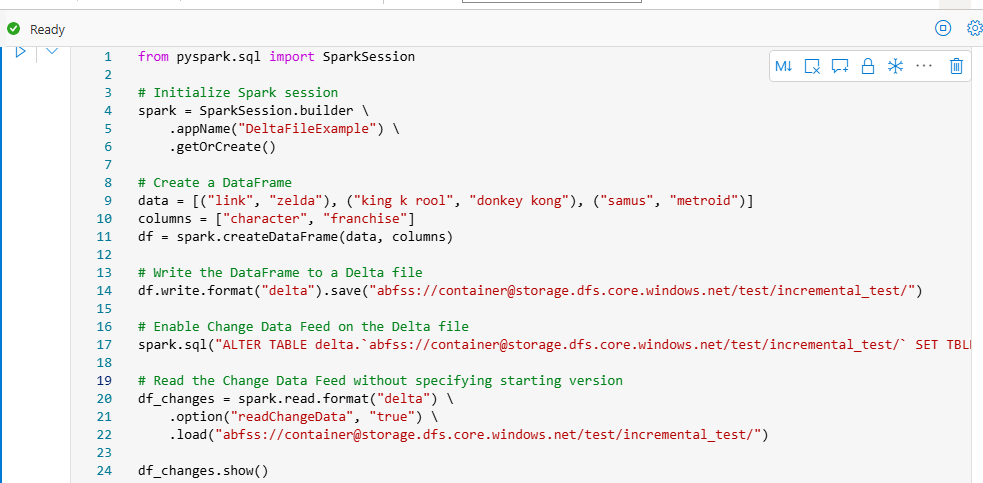

phemanth • 15,755 Reputation points • Microsoft External Staff • Moderator
2025-05-05T06:03:37.1366667+00:00 @SaiSekhar, MahasivaRavi (Philadelphia)
To enabling Change Data Feed (CDF) on a Delta file and reading the change data feed without specifying the starting version in PySpark.
Please check the below code dummy DataFrame, write it as a Delta file, enable CDF, and read the changes:
from pyspark.sql import SparkSession # Initialize Spark session spark = SparkSession.builder \ .appName("DeltaFileExample") \ .getOrCreate() # Create a DataFrame data = [("link", "zelda"), ("king k rool", "donkey kong"), ("samus", "metroid")] columns = ["character", "franchise"] df = spark.createDataFrame(data, columns) # Write the DataFrame to a Delta file df.write.format("delta").save("abfss://******@storage.dfs.core.windows.net/test/incremental_test/") # Enable Change Data Feed on the Delta file spark.sql("ALTER TABLE delta.`abfss://******@storage.dfs.core.windows.net/test/incremental_test/` SET TBLPROPERTIES (delta.enableChangeDataFeed = true)") # Read the Change Data Feed without specifying starting version df_changes = spark.read.format("delta") \ .option("readChangeData", "true") \ .load("abfss://******@storage.dfs.core.windows.net/test/incremental_test/") df_changes.show()

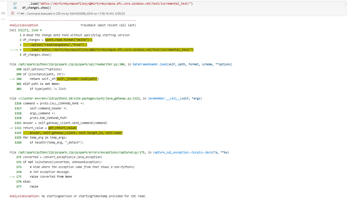

SaiSekhar, MahasivaRavi (Philadelphia) • 140 Reputation points
2025-05-05T11:10:34.1566667+00:00 Hi @phemanth,
Thanks for the update,After running the above script getting the below error ran the pyspark script provided by you, in delta file the columns are also not creating, currently I'm running in synapse notebook.
Can you please help me with the code and please send the result screenshots as well, please let us know if we need to install any python modules.

Dileep Raj Narayan Thumula • 255 Reputation points • Microsoft External Staff • Moderator
2025-05-06T10:50:51.98+00:00 Hello
@SaiSekhar, MahasivaRavi (Philadelphia),In Delta Lake Change Data Feed (CDF), the special columns (_change_type, _commit_version, _commit_timestamp) donot exist in the base table.
They appear only when you query the table with CDF enabled. So, you wont see them if you do a normal
SELECT * FROM delta table.
Also in synapse Ensure you are using Delta Lake 2.0+
because CDF works starting from Delta 2.0.
I have tried the below:
from pyspark.sql import SparkSession data = [("link", "zelda"), ("king k rool", "donkey kong"), ("samus", "metroid")] columns = ["character", "franchise"] df = spark.createDataFrame(data, columns) delta_path = "abfss://******@allnewsynp.dfs.core.windows.net/f1/incremental_test/" df.write.format("delta").mode("overwrite").save(delta_path) spark.sql(f"DROP TABLE IF EXISTS incremental_test") spark.sql(f"CREATE TABLE incremental_test USING DELTA LOCATION '{delta_path}'") spark.sql("ALTER TABLE incremental_test SET TBLPROPERTIES (delta.enableChangeDataFeed = true)") spark.sql("UPDATE incremental_test SET franchise = 'nintendo' WHERE character = 'link'")
In the above code
Registering it as table in the catalog (this is mandatory for CDF)
Doing an update to create a new version (CDF only works when there are changes)

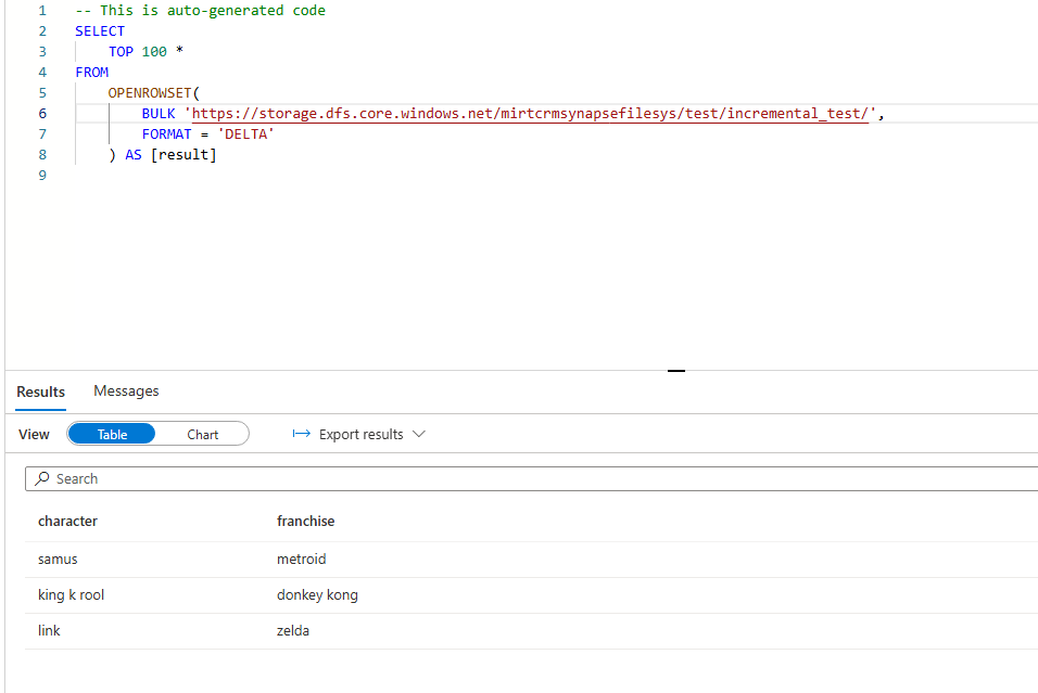

2025-05-06T11:41:48.0733333+00:00 Hi @Dileep Raj Narayan Thumula,
Thanks for the update,we are almost there, we are able to read the data using the below syntax but we are not able to display and write the data frame, can you please help me with the syntax and please share the result screenshots please.
please share the write syntax and result of it, Thank you.
Thank you for helping us.df_changes = spark.readStream.format("delta") \ .option("readChangeFeed", "true") \ .load("abfss://******@storage.dfs.core.windows.net/test/incremental_check/")

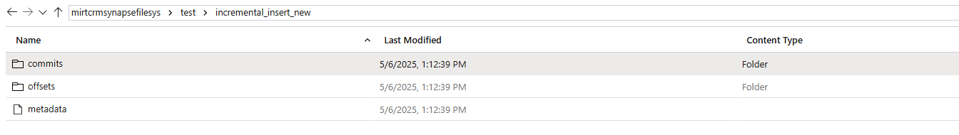

2025-05-06T13:41:53.1766667+00:00 Hi @Dileep Raj Narayan Thumula ,
The write command is working but where can we see the CDF data, we are seeing the below files in the folder.
Is it possible to display the streamdata frame and can you please share your inputs is it working as expected. we are able to write but not able to see the write data, which location it got saved,
Can you please share the output, Thank you for sharing this!
query = df_changes.writeStream \ .format("console") \ .option("checkpointLocation", "abfss://******@storage.dfs.core.windows.net/test/incremental_insert_new/") \ .start()
