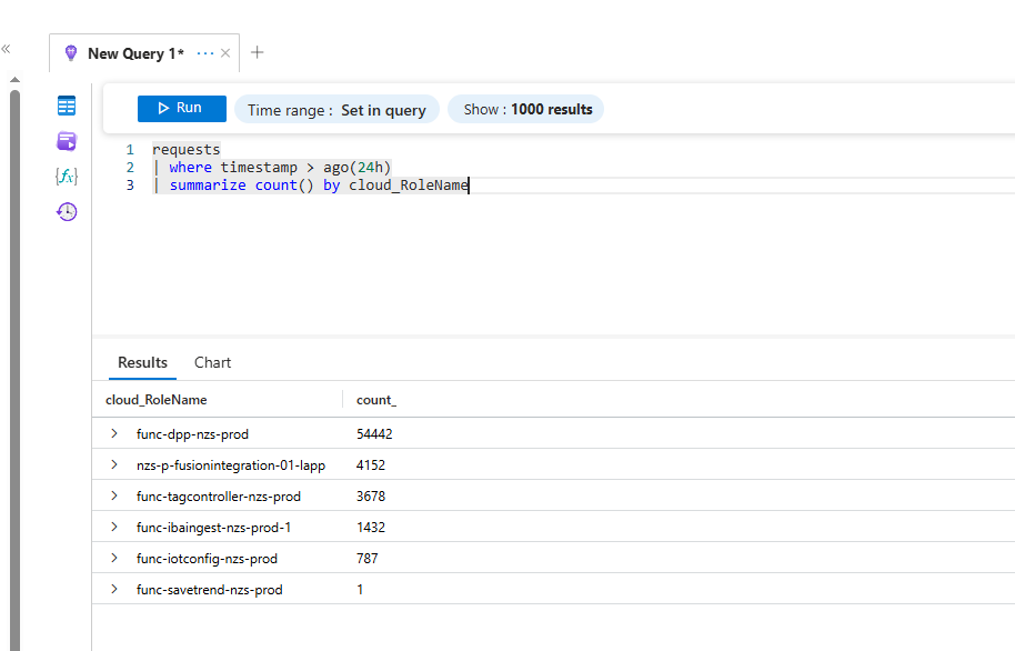

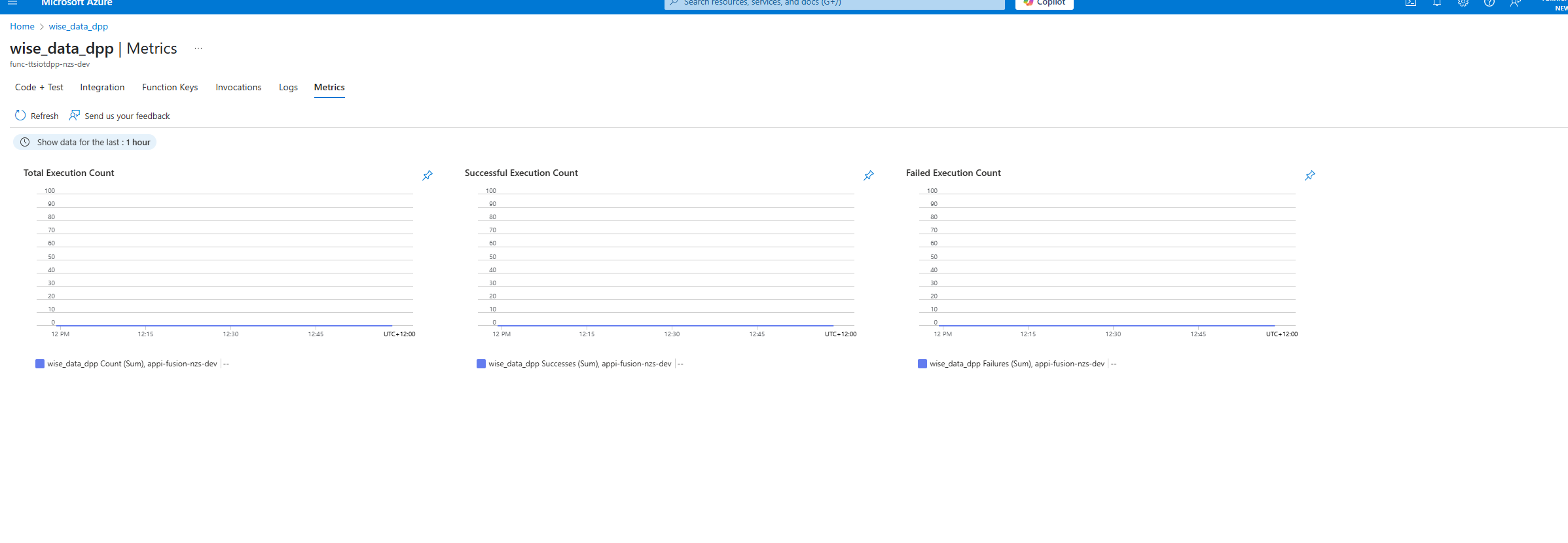

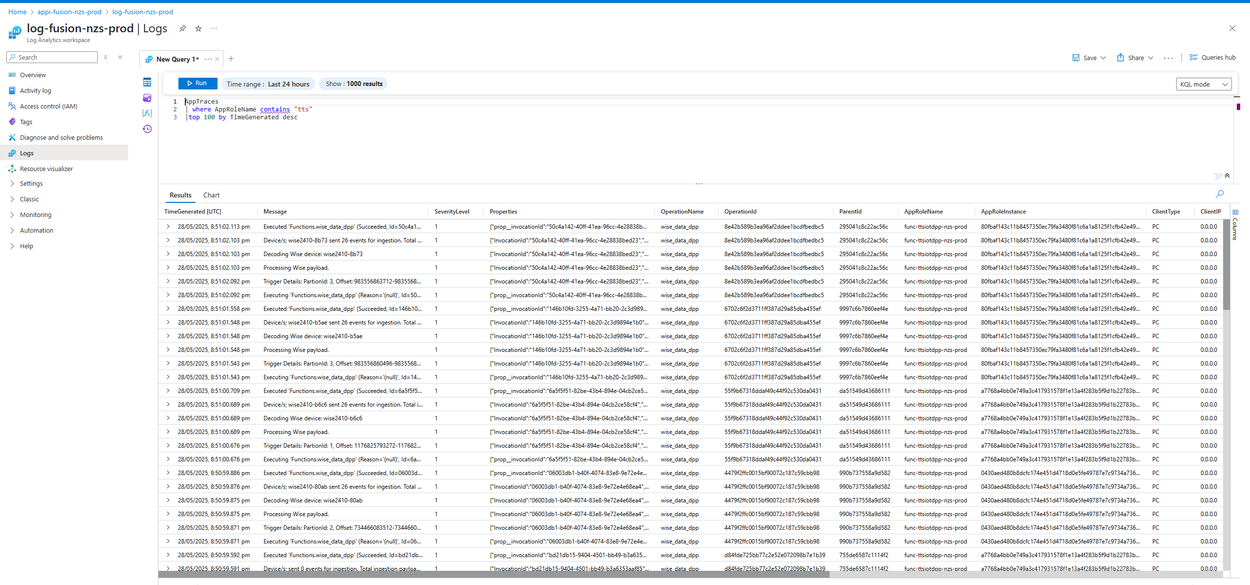

I have a function app with several functionthat is triggered when there's a new file in a blob storage.User's image

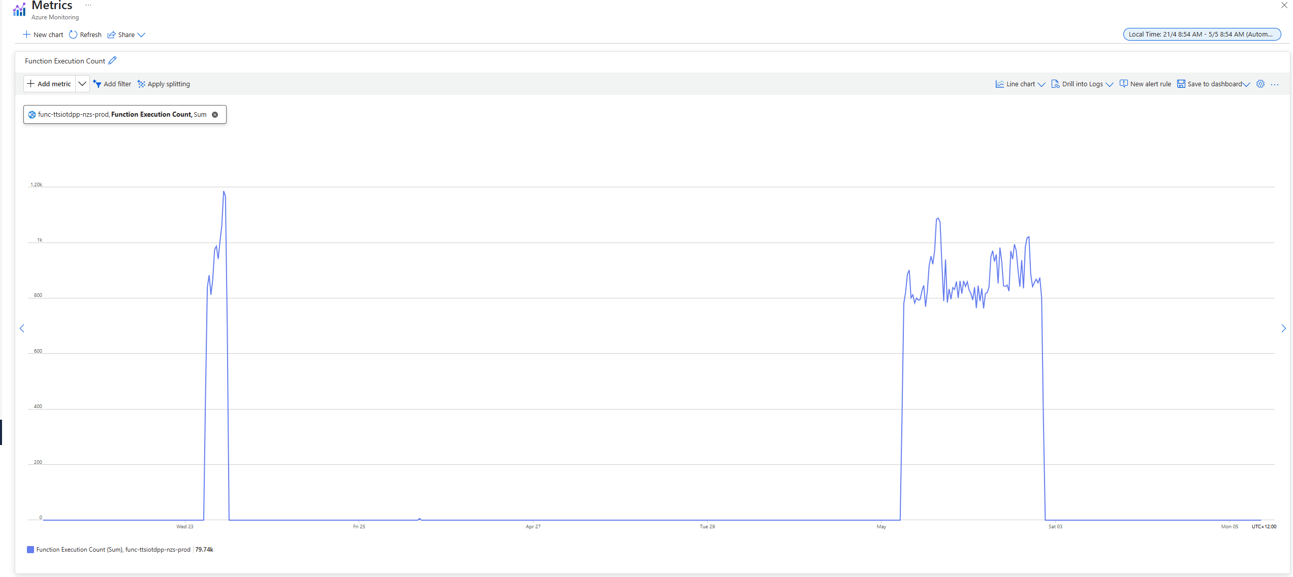

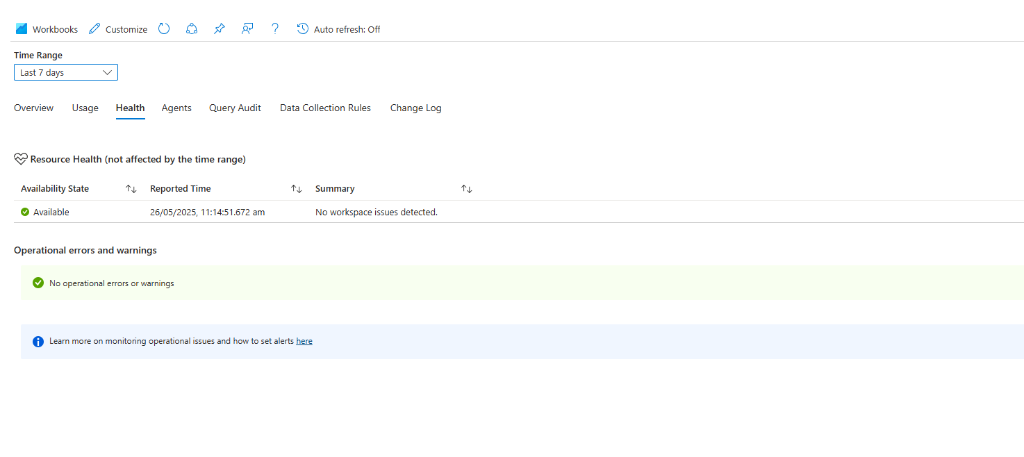

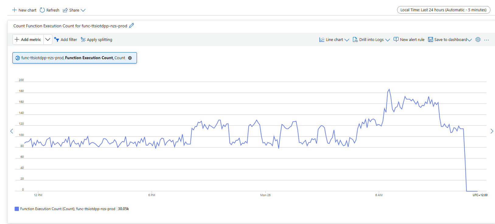

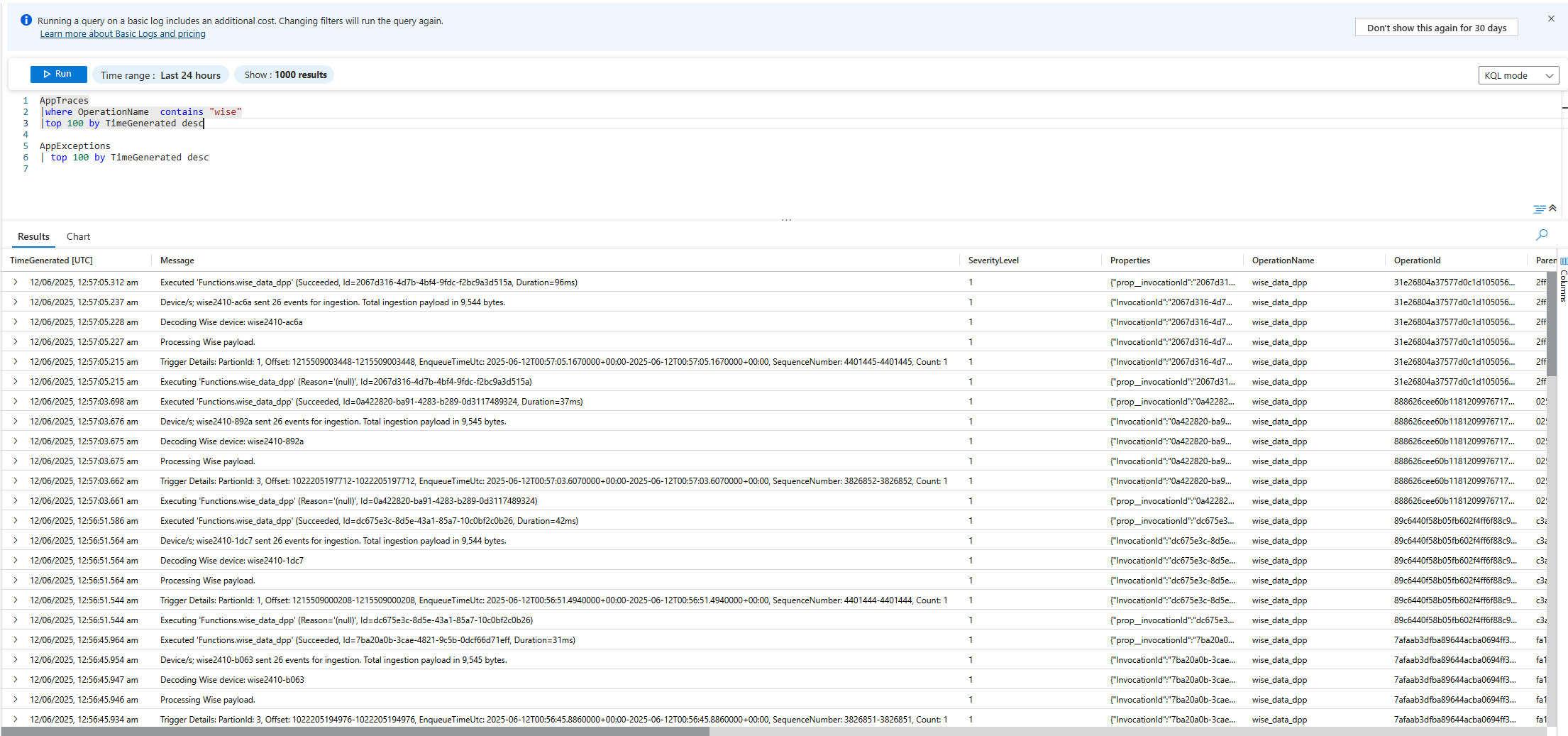

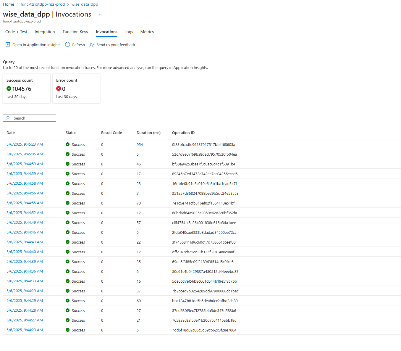

For some reason the metric "Function Execution Count" keeps going to zero. I've checked individual function and have seen they have defeintely run. I've also looked in the log analytics workspace and can see the functions running. Any reason why the Function Execution Count is showing zero? I use this metric to alert me and the fuction app isn't running

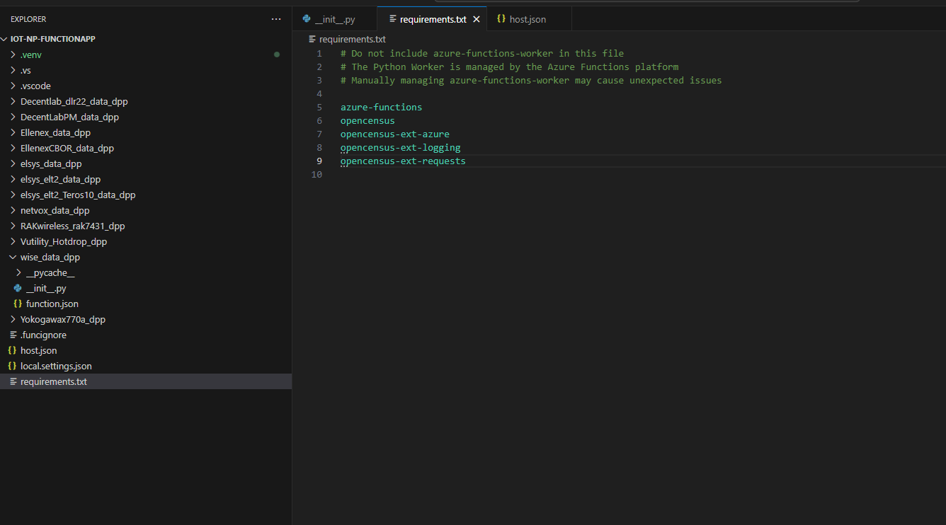

    Add below "host.json" in your code and make changes (function name) accordingly and check if the metrics are working.
      "version": "2.0",
      "logging": {
        "logLevel": {
          "default": "Information",
          "Function": "Information",
          "Host.Aggregator": "Information",
          "Host.Results": "Information",
          "Function.Function1": "Information",
          "Function.Function1.User": "Information"
      "applicationInsights": {
        "samplingSettings": {
          "isEnabled": false
        "enableLiveMetricsFilters": true
      "concurrency": {
        "dynamicConcurrencyEnabled": true,
        "snapshotPersistenceEnabled": true

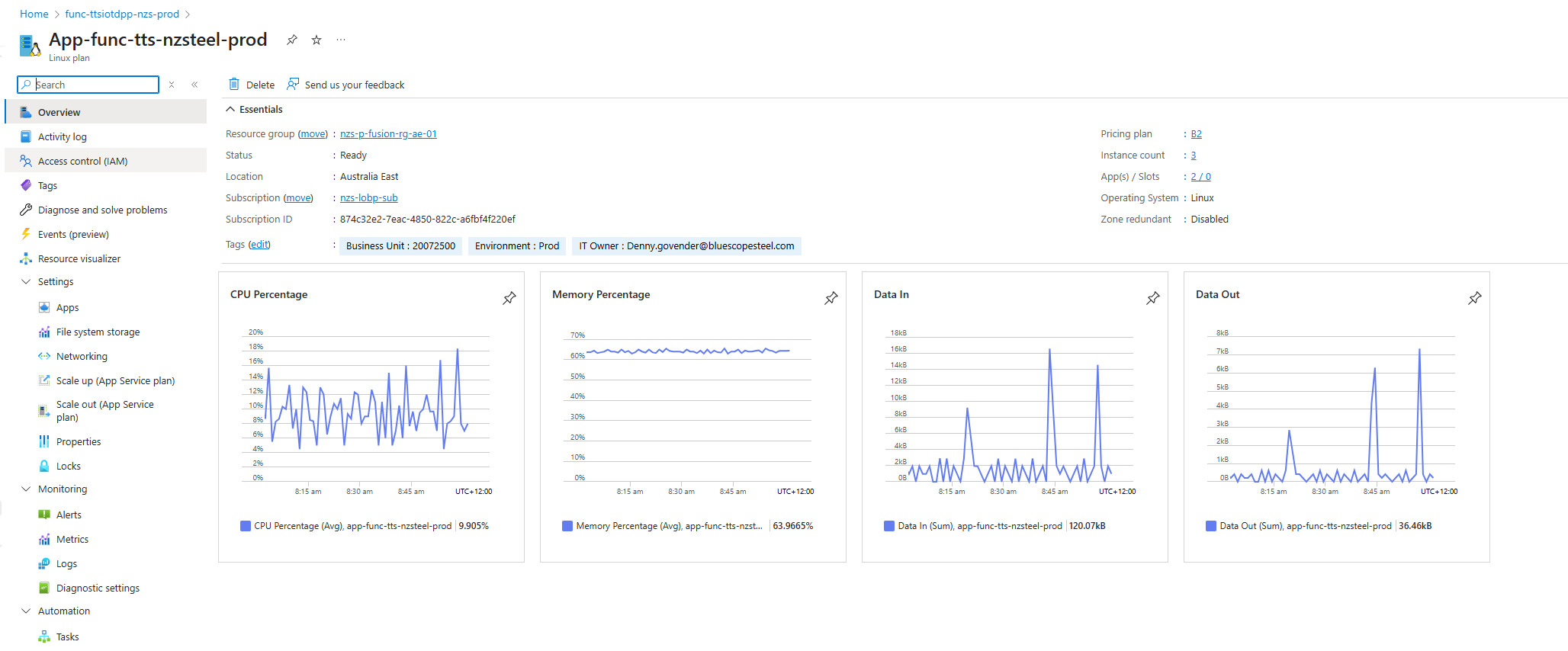

    Check the hosting plan of the dedicated function app and see if any one of the limitations are being hit.

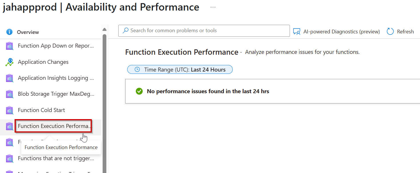

    You can go to the "Diagnose and solve problems" option under the Function App's resource menu contains scenario-based troubleshooting step that can be used to get more inputs on the Statistics related to function execution. Once you visit the above path, you can check for execution then it provides you the function execution counts related details.

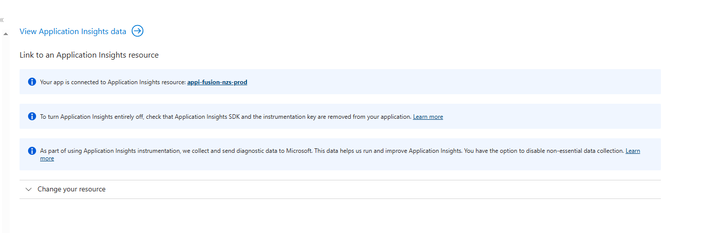

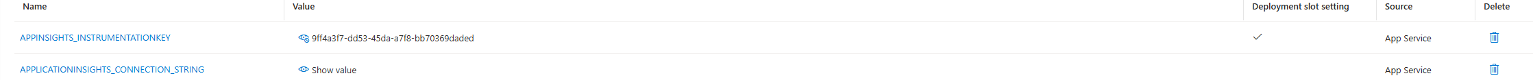

    Also, verify if you have configured and enabled the application insights properly regarding the logs and metrics part.
