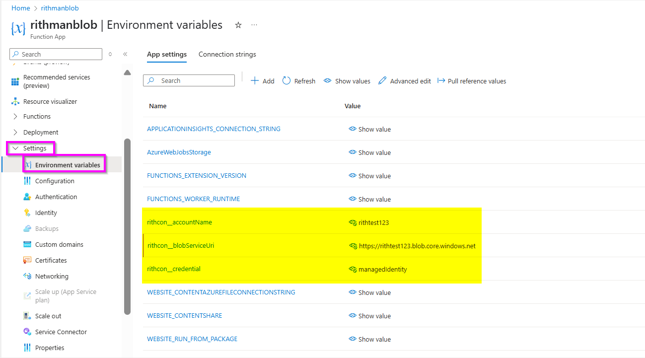

    Then in Environment Variables added below values:
    rithcon__accountName---->rithtest123
    rithcon__blobServiceUri---->https://rithtest123.blob.core.windows.net
    rithcon__credential---->managedIdentity

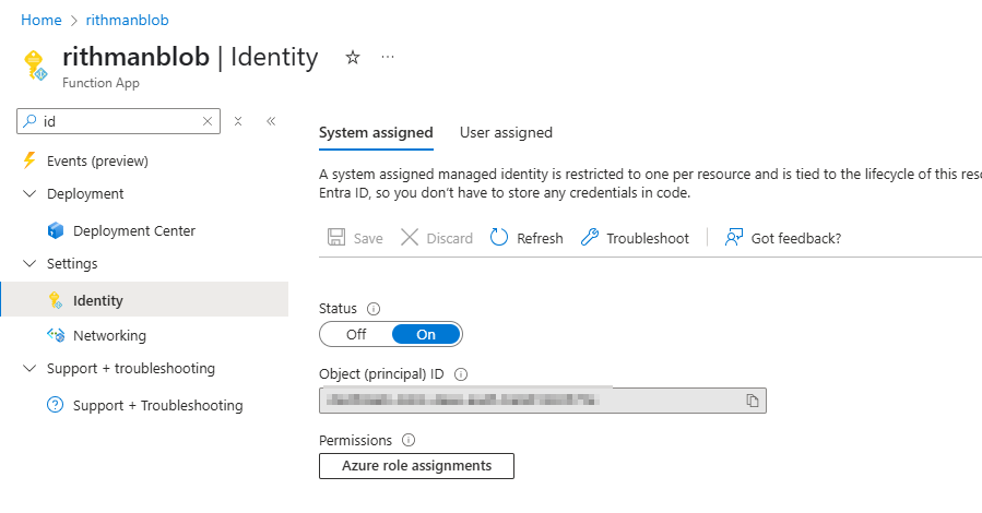

    Enabled Managed Identity as below:

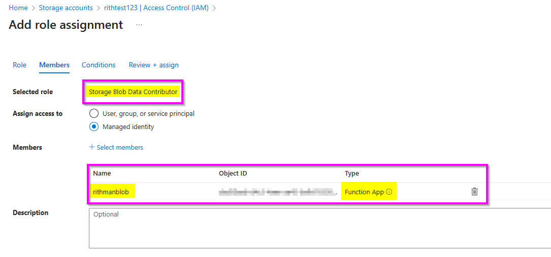

    Given Below Roles to Managed Identity of Function App in Storage Account:

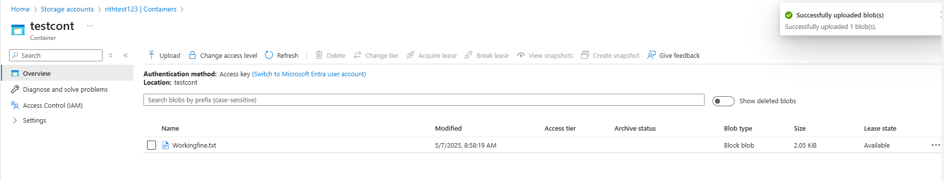

    Then Uploaded Blob:

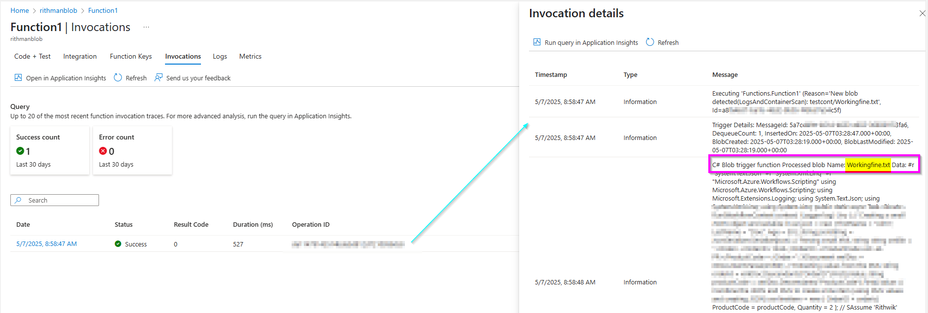

    The Function app gets triggered:
