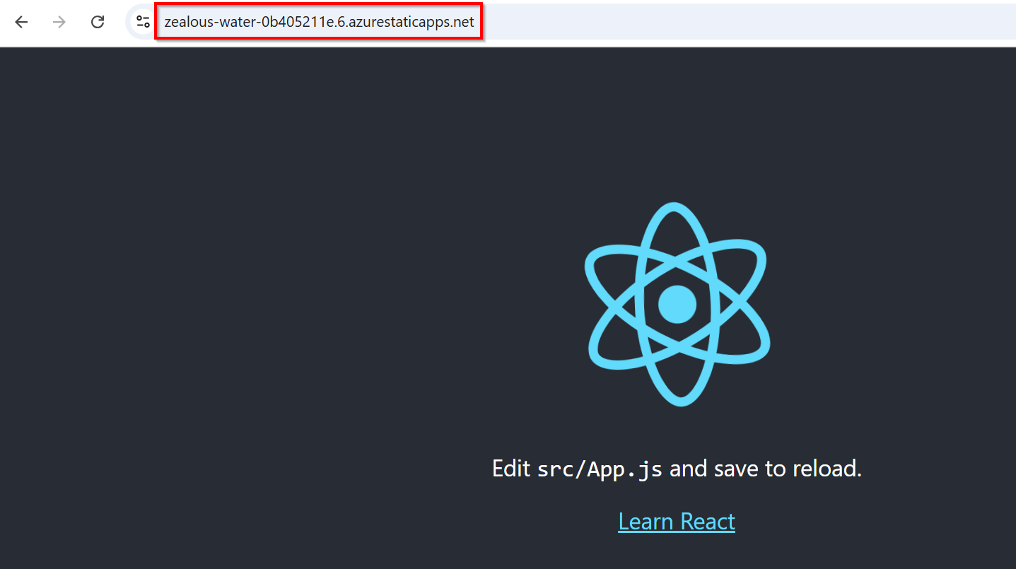

    Output:
    2025-05-07 10_25_08-React App
