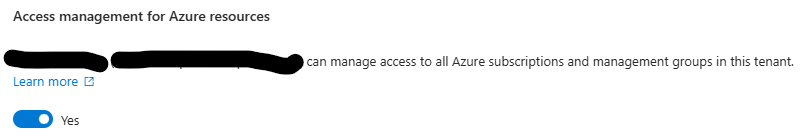

2025-05-07T08:20:01.0933333+00:00 Thanks TP
I am the only global administrator and there is only one directory listed, the default directory.
I believe I have elevated access
However, I am unsure if I have done this correctly as the IAM page is completely different to the help guide and shows me as the owner, not user access administrator.
TP • 124.7K Reputation points • Volunteer Moderator
2025-05-07T10:14:52.1533333+00:00 I am the only global administrator and there is only one directory listed, the default directory. I believe I have elevated access
Yes, it appears you have elevated your access correctly. Thanks for the screenshot. From the details provided so far it doesn't appear that you have access to the subscription.
