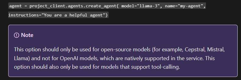

  1. Osama Tarek 105 Reputation points
    2025-05-19T06:52:03.9133333+00:00
    try to add this line to your code
    (1.0.0b9 version works)
    project_client.agents.enable_auto_function_calls(toolset=toolset)
    according to this github issue : https://github.com/Azure/azure-sdk-for-python/issues/40782
    import os
    from azure.ai.projects import AIProjectClient
    from azure.identity import DefaultAzureCredential
    from azure.ai.projects.models import FunctionTool, ToolSet
    from user_function import fetch_weather # user functions which can be found in a user_functions.py file.
    def fetch_weather(location: str) -> str:
        Fetches the weather information for the specified location.
        :param location (str): The location to fetch weather for.
        :return: Weather information as a JSON string.
        :rtype: str
        # In a real-world scenario, you'd integrate with a weather API.
        # Here, we'll mock the response.
        mock_weather_data = {"New York": "Sunny, 25°C", "London": "Cloudy, 18°C", "Tokyo": "Rainy, 22°C"}
        weather = mock_weather_data.get(location, "Weather data not available for this location.")
        weather_json = json.dumps({"weather": weather})
        return weather_json
    # Create an Azure AI Client from a connection string, copied from your Azure AI Foundry project.
    # It should be in the format "<HostName>;<AzureSubscriptionId>;<ResourceGroup>;<HubName>"
    # Customers need to login to Azure subscription via Azure CLI and set the environment variables
    project_client = AIProjectClient.from_connection_string(
        credential=DefaultAzureCredential(),
        conn_str="<projectconnectionstring",
    # Initialize agent toolset with user functions
    functions = FunctionTool([fetch_weather])
    toolset = ToolSet()
    toolset.add(functions)
    agent = project_client.agents.create_agent(
        model="Mistral-Large-2411-jkxfu", name="my-agent-2", instructions="You are a weather bot. Use the provided functions to help answer questions.", toolset=toolset
    print(f"Created agent, ID: {agent.id}")
    # Create thread for communication
    thread = project_client.agents.create_thread()
    print(f"Created thread, ID: {thread.id}")
    # Create message to thread
    message = project_client.agents.create_message(
        thread_id=thread.id,
        role="user",
        content="Hello, send an email with the datetime and weather information in New York?",
    print(f"Created message, ID: {message.id}")
    # Create and process agent run in thread with tools
    run = project_client.agents.create_and_process_run(thread_id=thread.id, agent_id=agent.id)
    print(f"Run finished with status: {run.status}")
    if run.status == "failed":
        print(f"Run failed: {run.last_error}")
    # Delete the agent when done
    project_client.agents.delete_agent(agent.id)
    print("Deleted agent")
    # Fetch and log all messages
    messages = project_client.agents.list_messages(thread_id=thread.id)
    print(f"Messages: {messages}")
    it solved the issue for me. Thank you
