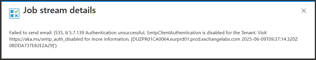

  2. Abdulaziz Yassin 0 Reputation points
    2025-06-10T10:47:19.12+00:00
    Thanks for following upp, we tested the code shared by you and this is the result:
