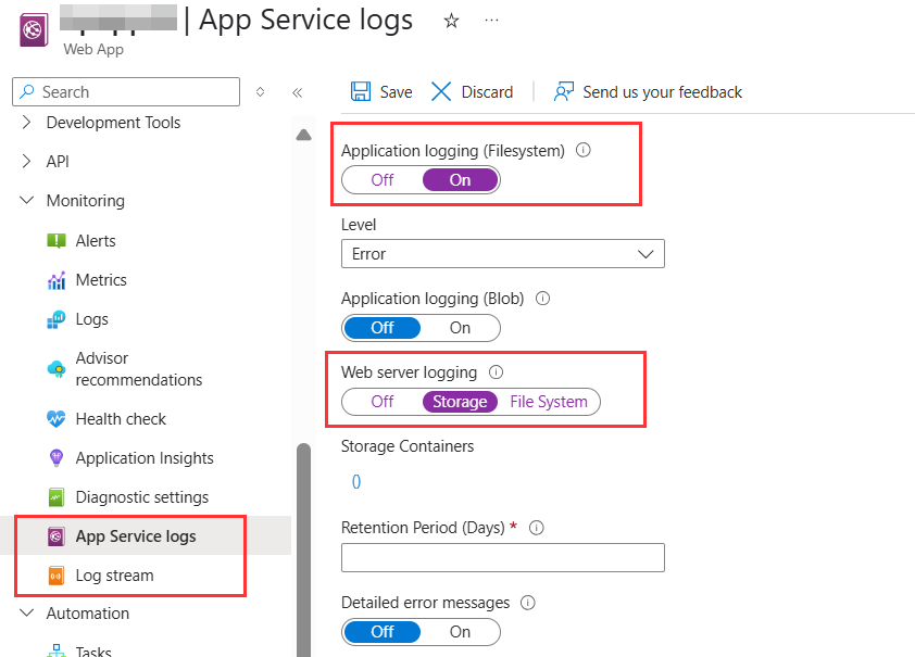

    Monitor application and web server logs:
    • Navigate to App Service=>App Service Logs.
    • Enable Application Logging and Web Server Logging.
    • Check the logs in Log Stream to find out the root cause of the abrupt restarts.

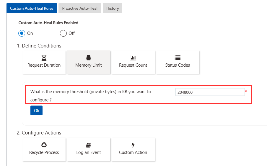

    Try updating Auto-Heal Rule:
    • Go to App Service => Diagnose and Solve Problems => Auto-Heal => Memory limit.
    • Edit the rule which monitors private bytes.
    • Increase the threshold to at least 1 GB or higher based on your requirement.
    • Alternatively, remove the memory-based auto-heal trigger completely if not needed.

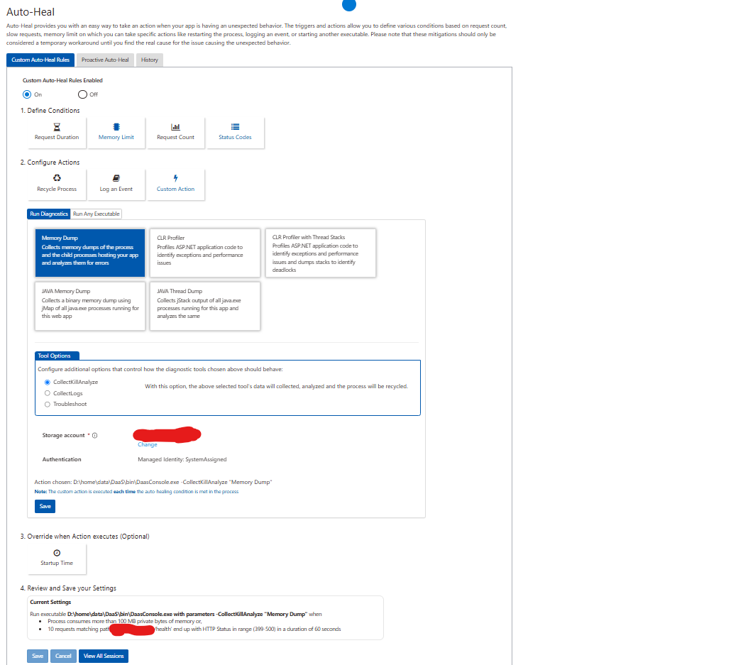

    2. Auto heal settings are on and like below.User's image

    I observed my current auto heal settings are set with respect to memory limit. If a process consumes more than 100 MB private bytes of memory then a memory dump will be created. Is this causing a sudden restart as current process might be consuming more than 100 MB of memory? P1mV3 has 2 cores 16 GB memory.
