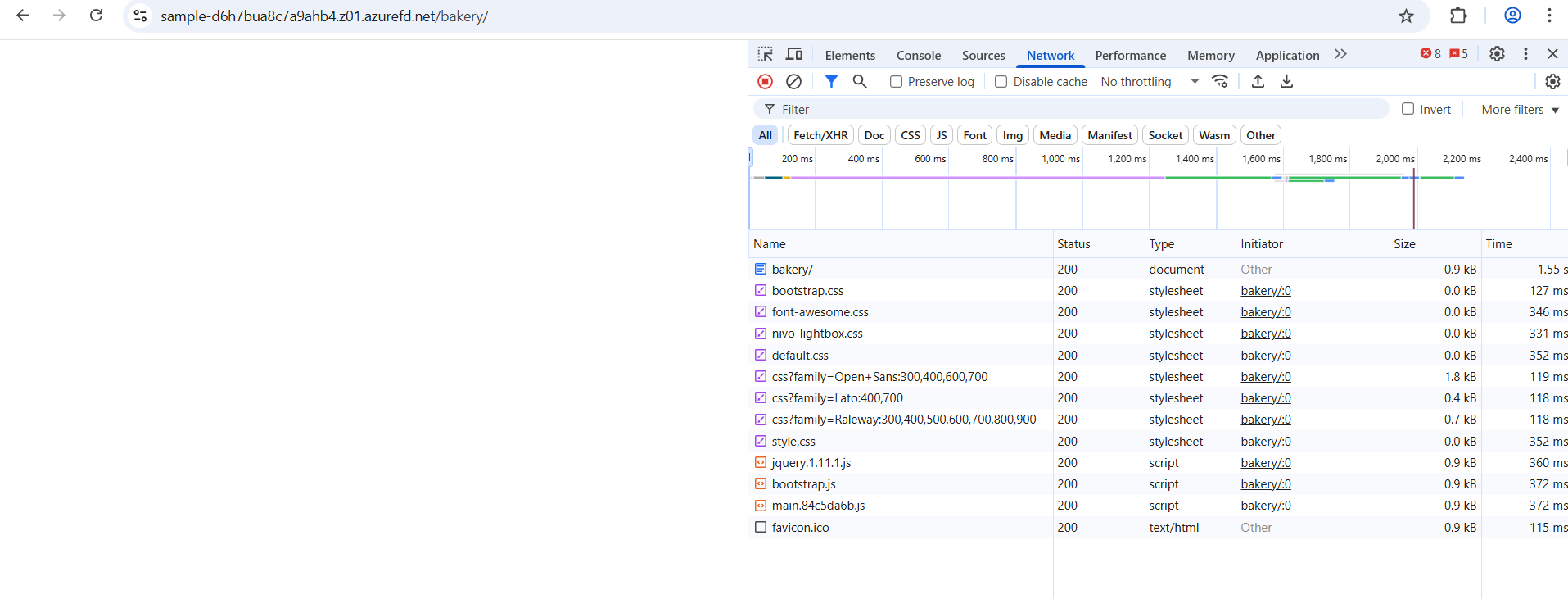

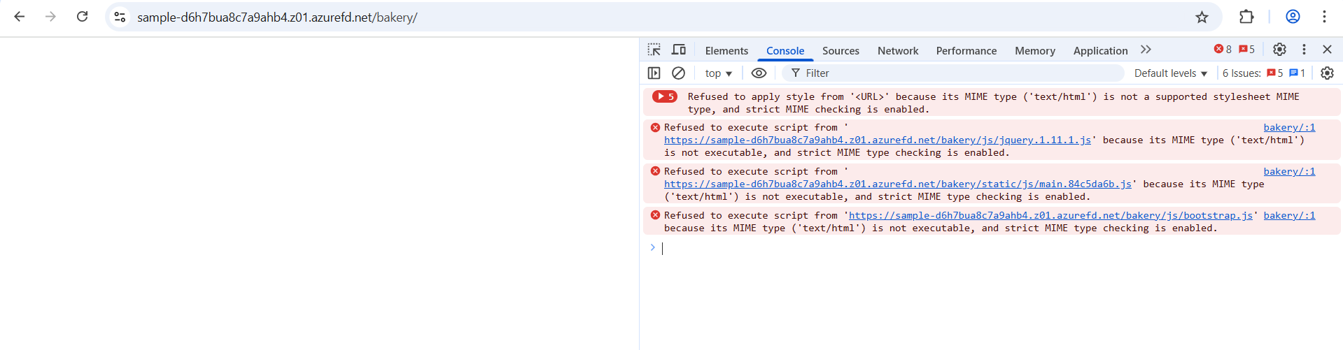

Problem Observed:
Accessing https://sample-d6h7buaXXXXXXXX.z01.azurefd.net/bakery correctly routes to Static Web App 2 (Bakery) and loads the index page.

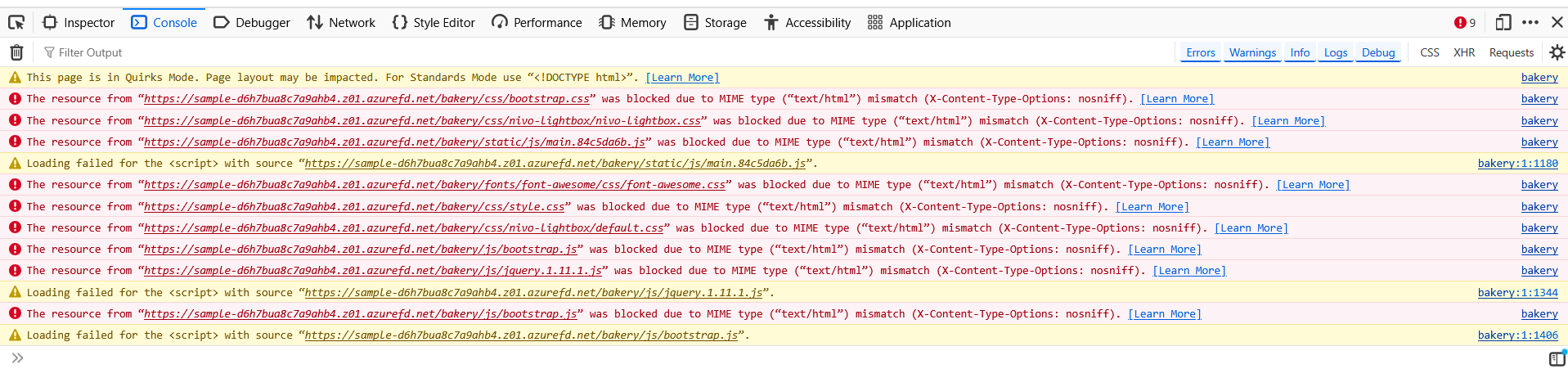

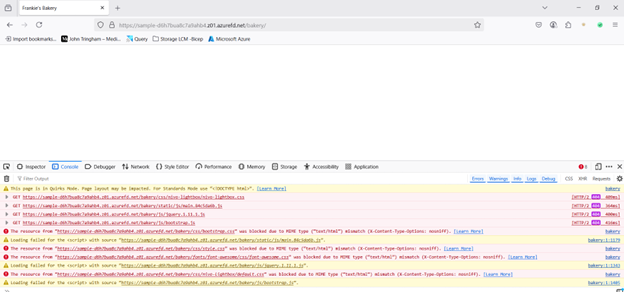

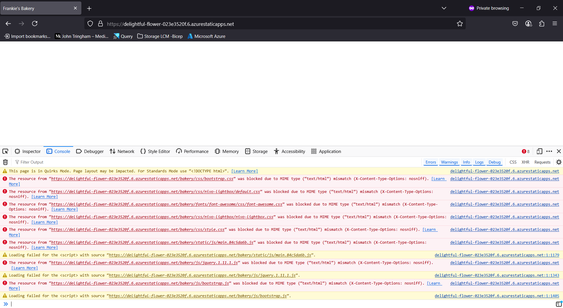

However, all JavaScript, CSS, and static assets requested by the Bakery app are being misrouted.
These assets are incorrectly routed back to Static Web App 1 (the default route /*), leading to:
404 errors
  **Blank screen or broken UI**
  The underlying issue appears to be that the assets are requested using relative paths that are not adjusted to match the `/bakery/*` base path.

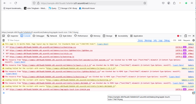

    Hi @Ravi Praneeth
    As seen above, the error occurred because the package.json file does not have the correct configuration to route the application properly.
    Your React app was built for the root path (/), but you were serving it from a subpath (/bakery/) via Azure Front Door. Because of this mismatch, the browser tried to load static assets like.
    /bakery/css/bootstrap.css
    /bakery/static/js/main.js
    To resolve this issue, update the package.Jsonfile with the following entry:
    "homepage": "/bakery"

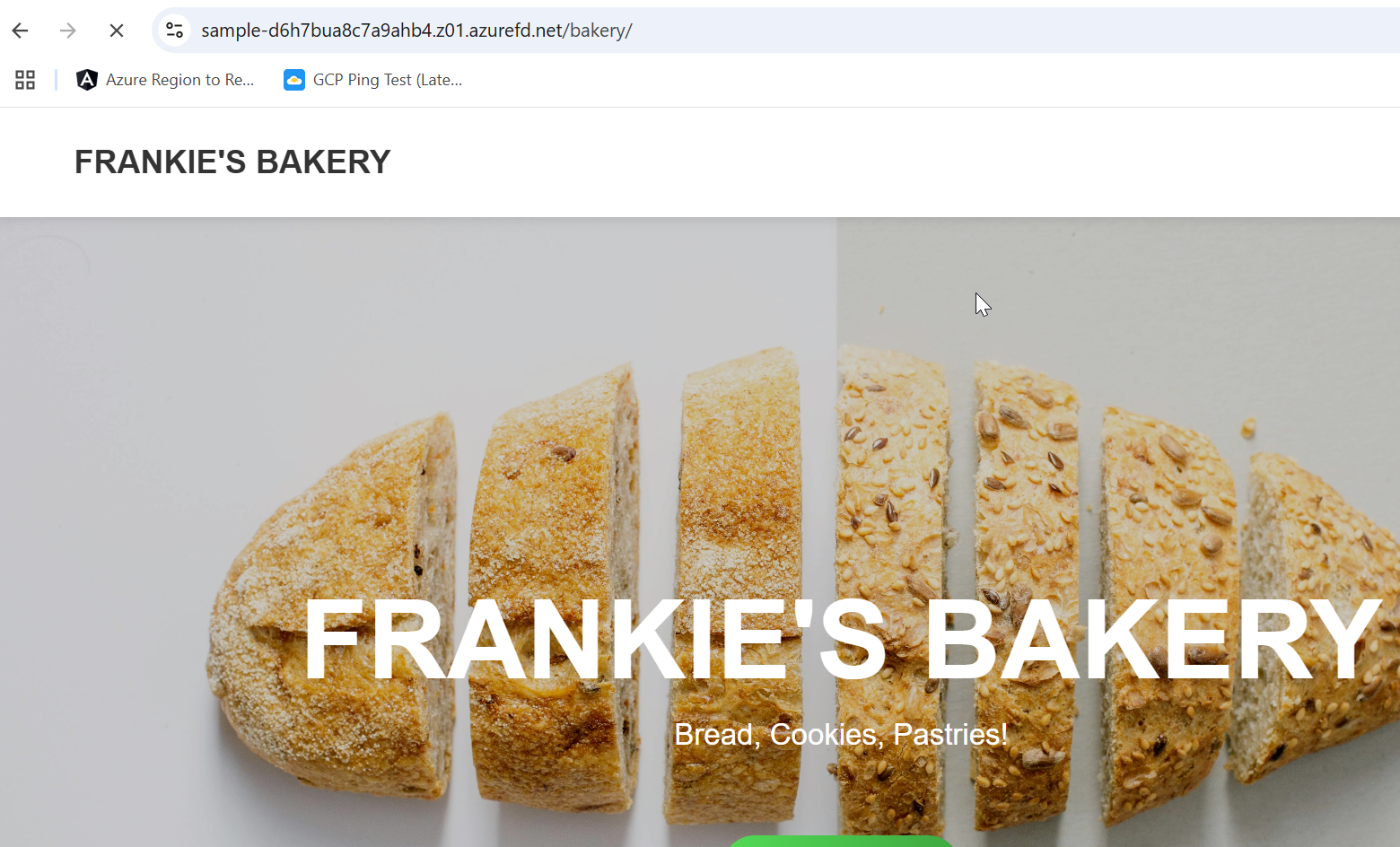

    After updating the code and rebuilding the app, it loads properly, as shown below
