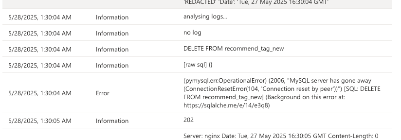

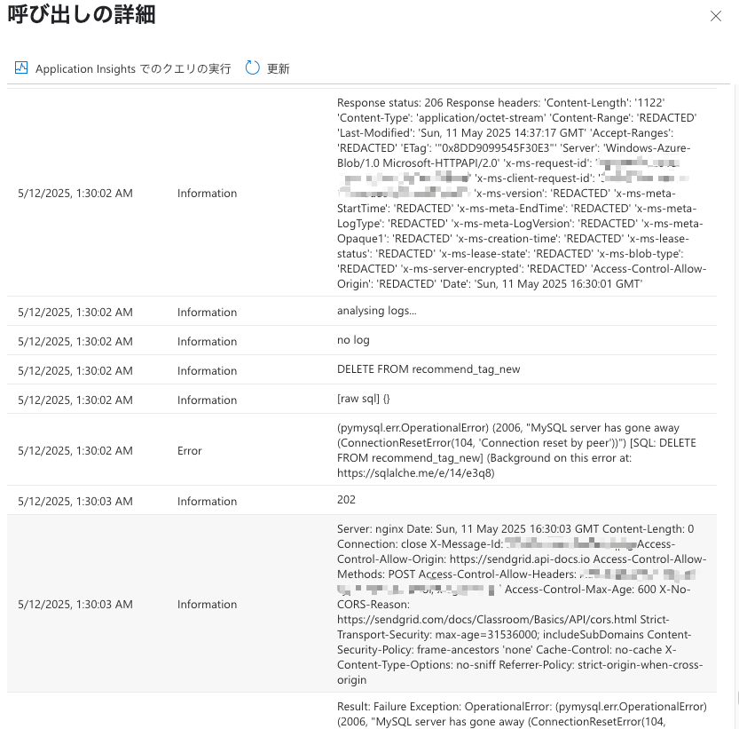

Occurrence Time: 1:30 AM JST
Occurred Query: (The query is one executed by the App Service at scheduled times)
TRUNCATE TABLE table_name
Reproduction:
By manually restarting the DB instance and executing the App Service function, the error is reproduced.
Inexplicable Issue:

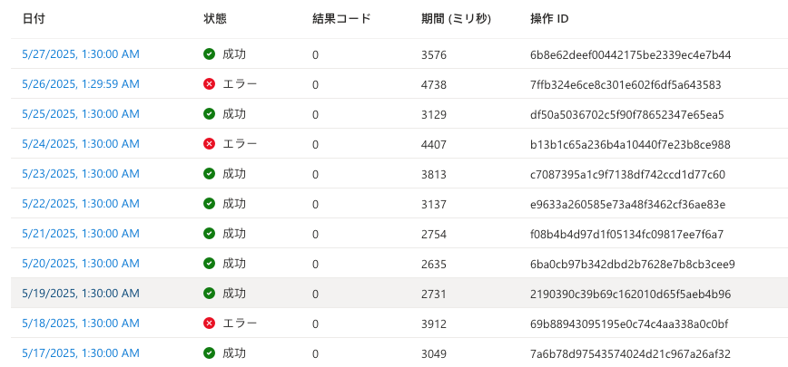

The error does not occur every day, but rather every other day.
