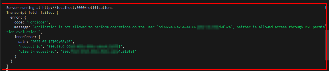

However, the API responds with the following error:
Application is not allowed to perform operations on the user 'xxx', neither is allowed access through RSC permission evaluation

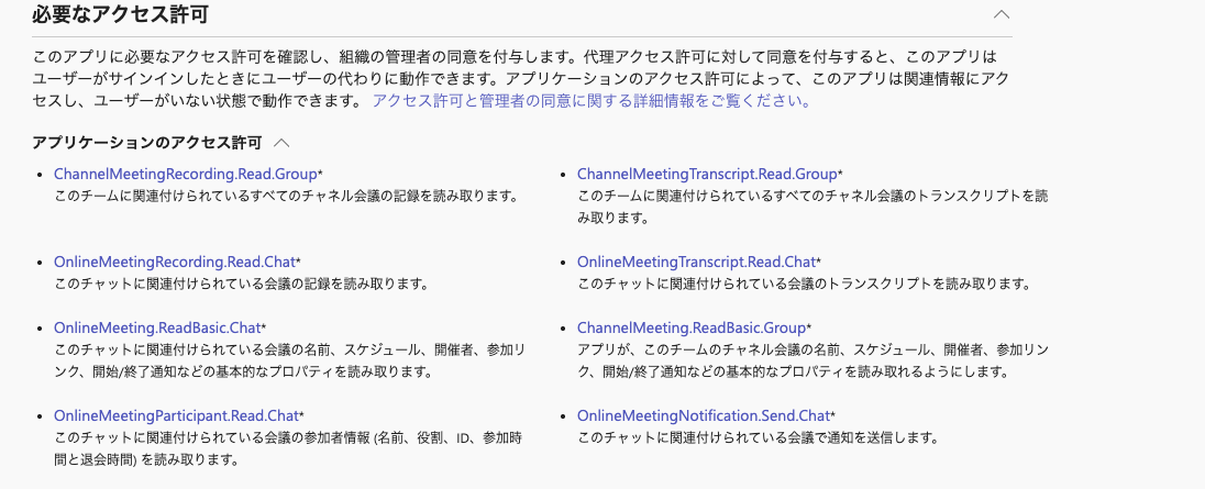

Our application appears to have the correct permissions for RSC. The relevant section from our manifest is below:
  "authorization": {
    "permissions": {
      "resourceSpecific": [
          "name": "ChannelMeetingRecording.Read.Group",
          "type": "Application"
          "name": "ChannelMeetingTranscript.Read.Group",
          "name": "OnlineMeetingRecording.Read.Chat",
          "name": "OnlineMeetingTranscript.Read.Chat",
How can I fix this issue? References I've consulted the following documentation: https://learn.microsoft.com/en-us/graph/teams-changenotifications-callrecording-and-calltranscript?toc=%2Fmicrosoftteams%2Fplatform%2Ftoc.json&bc=%2Fmicrosoftteams%2Fplatform%2Fbreadcrumb%2Ftoc.json https://learn.microsoft.com/en-us/graph/api/resources/calltranscript?view=graph-rest-1.0&toc=%2Fmicrosoftteams%2Fplatform%2Ftoc.json&bc=%2Fmicrosoftteams%2Fplatform%2Fbreadcrumb%2Ftoc.json

To resolve this, ensure your app has the following Application permissions granted with admin consent in Microsoft Entra ID:

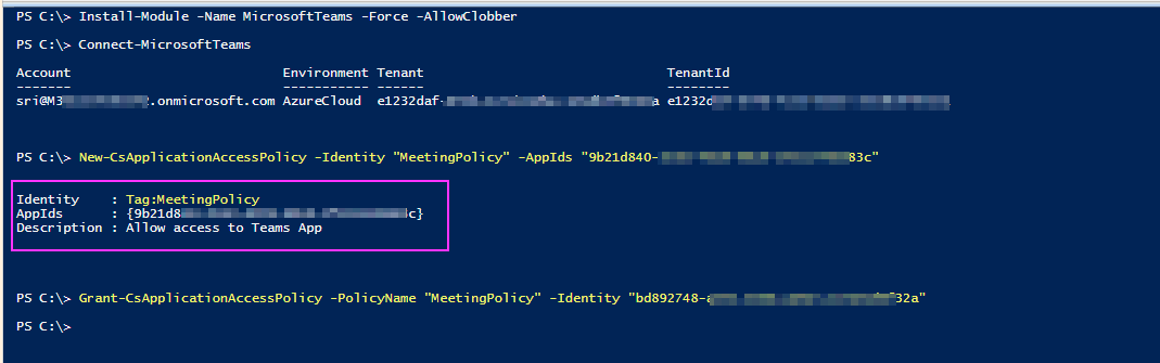

After that, use below PowerShell script to create and assign the Application Access Policy. Make sure to run it while connected to Microsoft Teams using an admin account:
Install-Module -Name MicrosoftTeams -Force -AllowClobber
Connect-MicrosoftTeams
New-CsApplicationAccessPolicy -Identity "MeetingPolicy" -AppIds "YourAppId"
Grant-CsApplicationAccessPolicy -PolicyName "MeetingPolicy" -Identity "UserObjectId"
Once applied, it may take up to 30 minutes for the policy to take effect. After that, your API call should work if the user in the URL is the meeting organizer and is covered by the policy.
