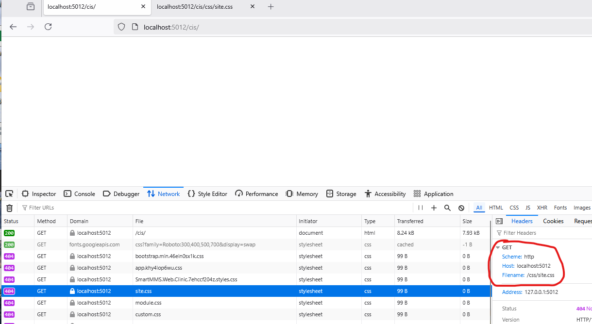

I have a problem with implementing reverse proxy with yarp and blazor serevr 9.0.
In my api project (which use yarp nuget package) i've write this script to transmit incoming request to destination address which is blazor server 9.0 and hosted on my iis (port 82) :
"ReverseProxy": {
  "Routes": {
    "raytebRoute": {
      "ClusterId": "raytebCluster",
      "Match": {
        "Path": "/cis/{**catch-all}"
      "Transforms": [
          "PathRemovePrefix": "/cis"
          "RequestHeaderOriginalHost": "true"
  "Clusters": {
    "raytebCluster": {
      "Destinations": {
        "site": {
          "Address": "http://localhost:82/"
But not works correctly!

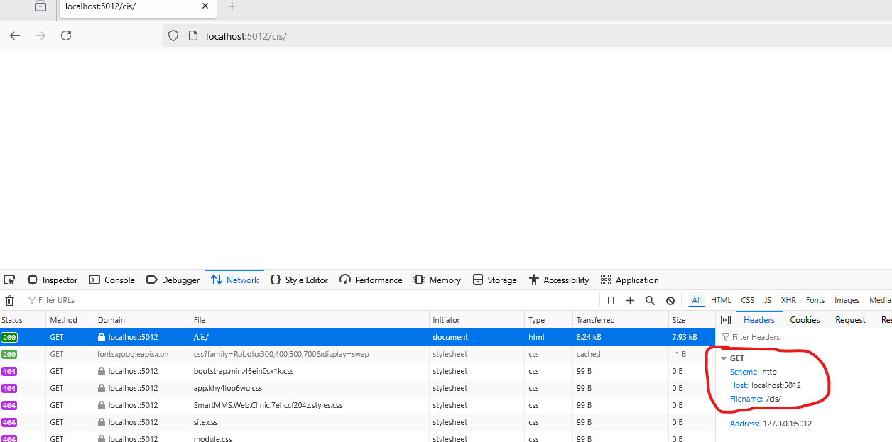

When i check it in my browser developer tools > network tab, It found the destination address but didn't found resources like js, css, etc!
I've also found this link, but it is for .net core 6.0 and 7.0 and it seems this problem solved in asp.net core 8.0 and above!
Can anybody help me to solve this problem?
Thanks in advance
