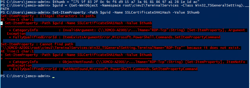

    The core issue here is that your RDP port (62458) and others (443, 64987) are using either expired or self-signed certificates, which PCI scans will always flag as insecure. You're connecting to your VM via jemco-az001.cloudapp.net, which is an Azure-assigned DNS name. Here's the catch- public SSL certificate authorities will not issue certificates for these default .cloudapp.net domains, which is why your attempt to create an App Service Certificate failed.
    To fix this, you’ll need to buy a domain name (if you don’t already have one). Create a DNS record like rdp.jemcohosting.com and point it to your VM’s public IP. Purchase an SSL certificate for that domain and install it on the VM and bind it to your RDP service using PowerShell
    $thumb = "<your_cert_thumbprint>"
    $guid = (Get-WmiObject -Namespace root\cimv2\TerminalServices -Class Win32_TSGeneralSetting).__PATH
    Set-ItemProperty -Path $guid -Name SSLCertificateSHA1Hash -Value $thumb
    Restart-Service -Name TermService -Force
    This should ensure the RDP connection is encrypted with a publicly trusted certificate, which should clear that PCI finding.
