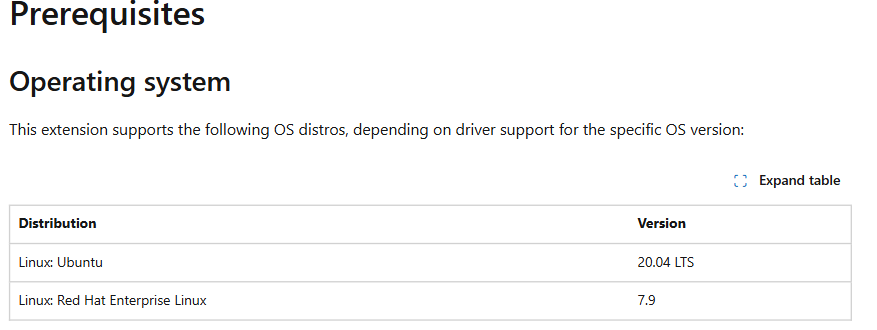

    When you trying to install nvidia drivers on the ubuntu there is supporting OS mentioned below
    Installing NVIDIA drivers via the Azure extension**: The extension only supports Linux Ubuntu 20.04 LTS, meaning users can install drivers automatically through Azure without manual steps.
    Please refer below SS & documentation once
    Operating system
    1. Installing NVIDIA drivers manually: If users are running Ubuntu 22.04 LTS or later, they must install the drivers manually, as the Azure extension does not support automatic installation for these versions.
      Please refer the SS & documentation
