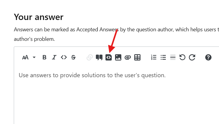

    You posted the Powershell script as normal text. This forum is interpreting some characters in your script as formatting directives. That's why your question has multiple grey boxes. Please edit the question and repost the script using the Code Block tool.

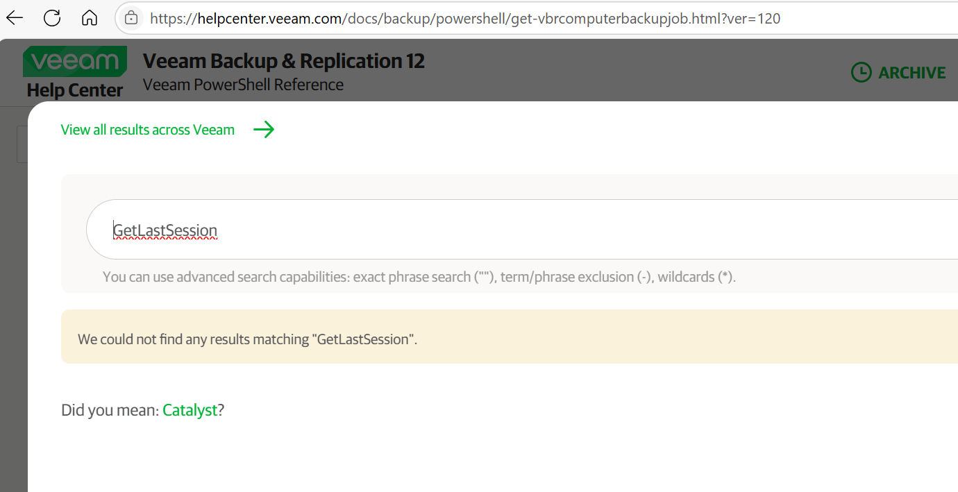

    ...then the assumption would be that Veeam is not exposing that method.
    Have Powershell list all methods and properties like this.
    $job | get-member
    I found a Get-VBRSession cmdlet documented here.
    https://helpcenter.veeam.com/docs/backup/powershell/get-vbrsession.html?ver=120
    You would need to consult the Veeam documentation on the proper way to query a session. That would be Veeam specific, and we really can't help you with that.
