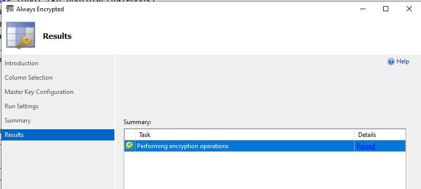

After adding column encryption to a table in our database our stored procedures changed their formatting (spaced and indentations changed). Below is a sample before and after.

Make sure that you don't have the option "Enable Always Encrypted" on the Always Encrypted tab in the Connection dialog from the connections where you edit stored procedures.
When you have this option enabled, and you also have enabled parameterisation for Always Encrypted, SSMS will analyse yourr code to replace constants with encrypted values.
