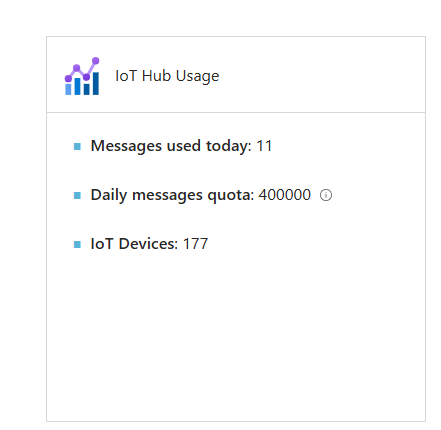

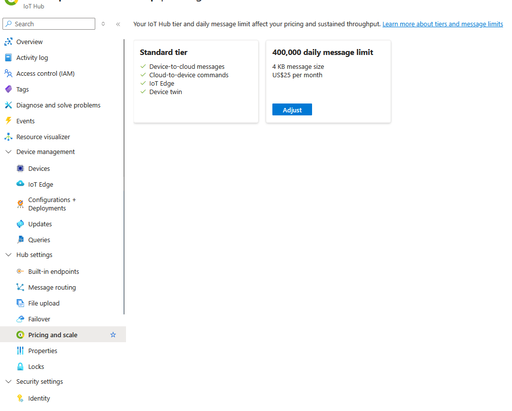

Hello,
Is there a way to reduce the cost of our IoT Hub?
We are currently on a Standard Tier.
I want to know if there are ways to lessen the cost of our IoT hub in development environment since there are no projects on going.
I checked if theres an option to scale down however I cant find one and also we have IoT devices registered already.
I also dont want to lose any configuration in case there will be a project and the need for it in the future.
Thank you.

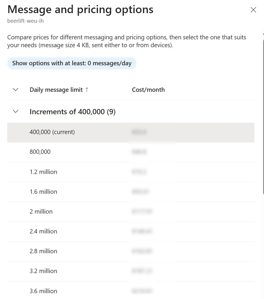

    An IoT Hub is created as either Free (limited in features, only one per subscription), Basic (only ingest), or Standard tier (having all features).
    Upgrading is possible but downgrading is less obvious and it's not simply using a dropdown box...
    If you want to scale down, you probably need to reduce the number of IoT Hubs (moving dev, test, acceptance, and production devices to one IoT Hub and using tags to separate them) or you need to recreate a new IoT Hub having lesser features.
