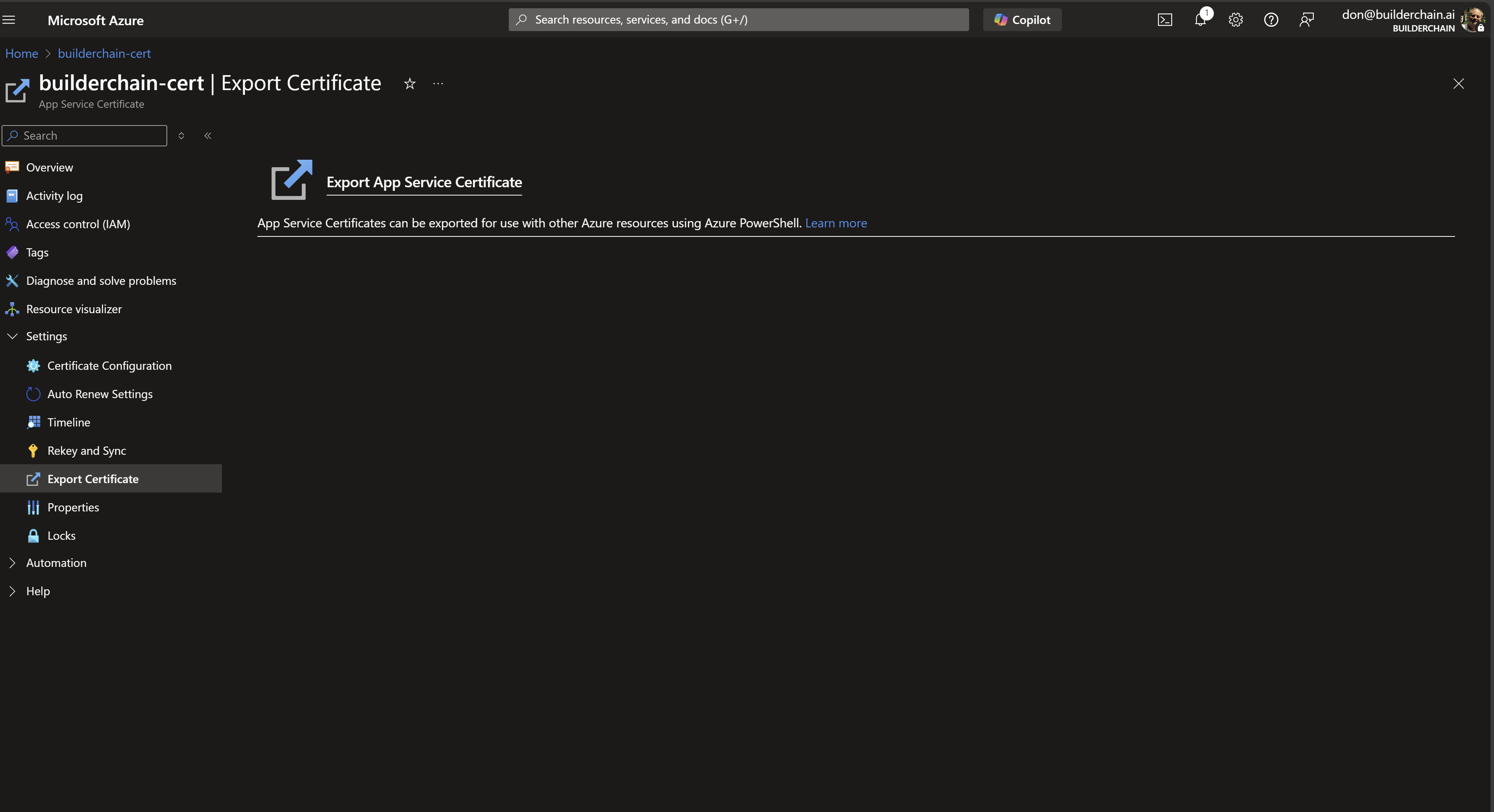

I have purchased app services App Service Certificates. I need to confirm the domain associated with my SSL certificate. Then i believe it needs to downloaded from Azure App Services and uploaded into Power Pages "custom domain" configuration. However, when we do SSL Binding on the Power Pages custom domain, it throws this error as below:
Can you please help me generate the correct certificate for use with the "custom domain" configuration with our Power Pages website.

    Also, checking the requirements of the certificate for Power Pages here: https://learn.microsoft.com/en-us/power-pages/admin/add-custom-domain
    The certificate you're importing must be password-protected. By default, when you export an App Service Certificate, it is not password protected. In which case, please use a local tool such as OpenSSL or the Windows Certificates snap-in to import, then export your certificate and be sure to password protect the exported certificate. Then, try uploading that to your Power Pages and see if the certificate will then bind successfully.
