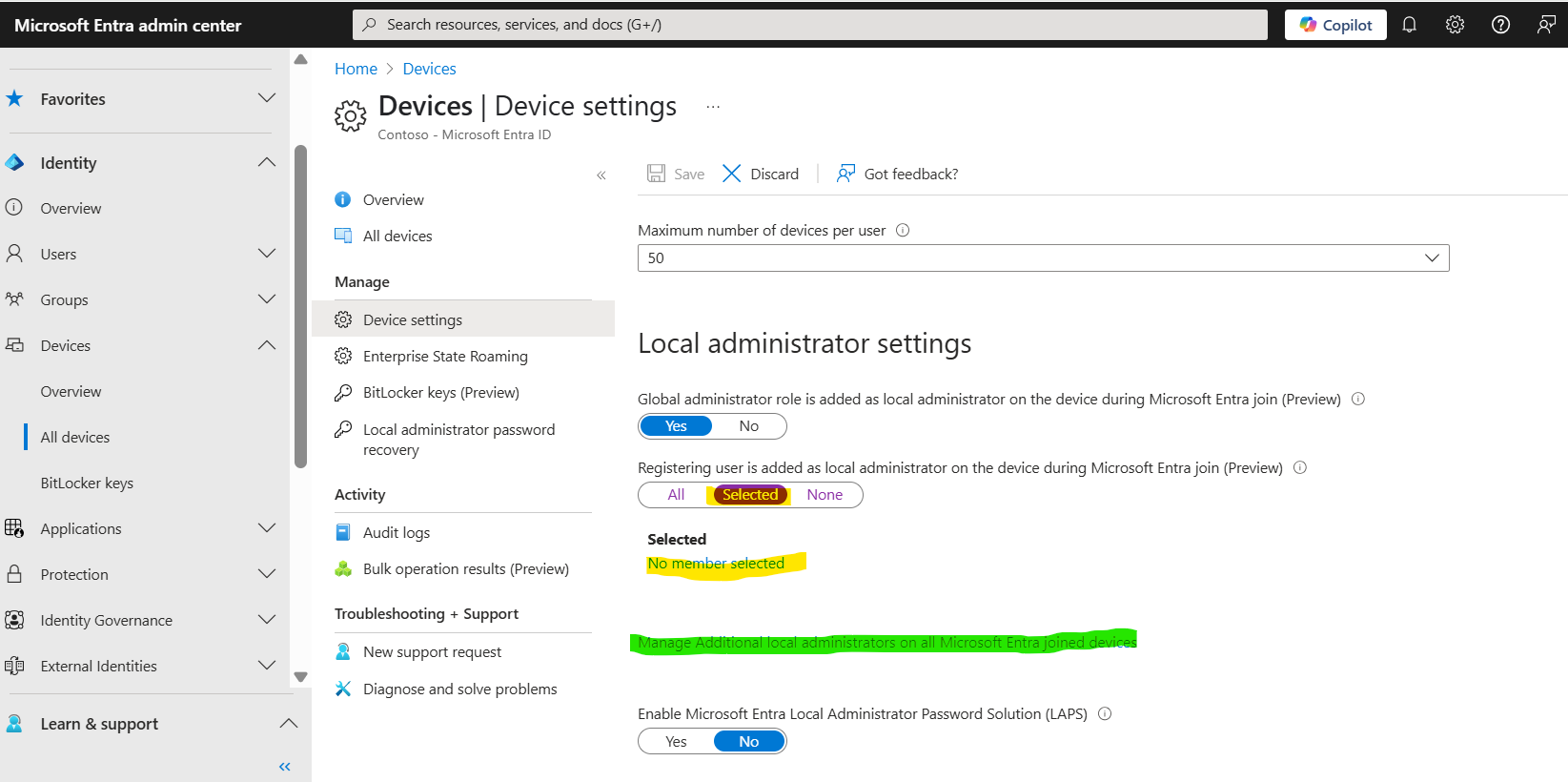

    may I know how you added administrators in Entra portal under Local administrator settings.
    Have you selected the users using the option "Registering user is added as local administrator on the device during Microsoft Entra join"
    Or
    you have added the users under Manage Additional local administrators on all Microsoft Entra joined devices settings.
    Post adding joining the device may I know what the issue is you have noticed.

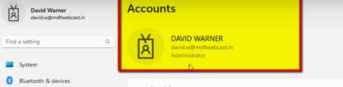

    have you check the administrator's profile is it shows Administrator as show in the below.
