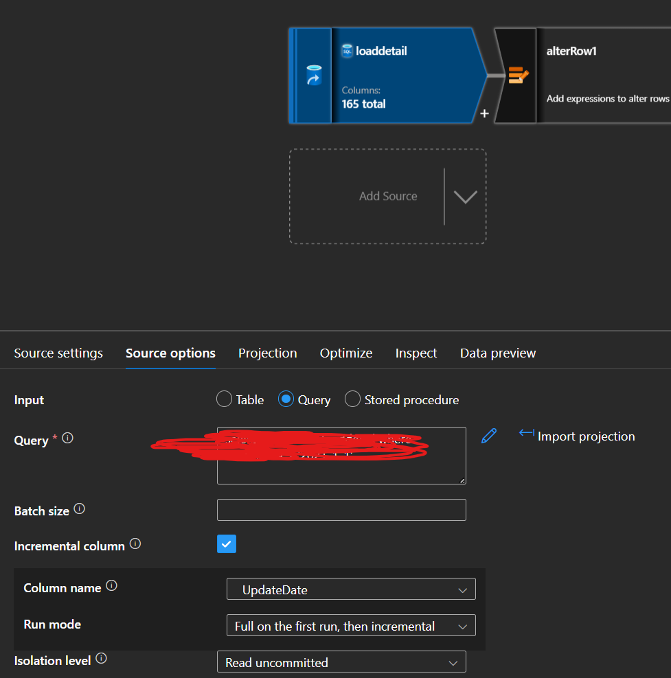

I've been working on this for a couple of weeks and I would appreciate your input:
I'm attempting to build an incremental copy pipeline with ADF to get the data into a data lake. It seems like I need to use a dataflow for this, so I've done that. I have the source set up as a single table in AZ sql db with the "incremental column" set up as "lastUpdateDate", and the sink set up as an inline delta table (it seems the table must be inline for delta to work).
What I want is for the data in the lake to be a direct copy of what's in the db - meaning, if a row is deleted, I want it deleted from the delta lake too. So, I've enabled the options "allow upsert, delete, insert, and update" on the sink settings for delta. If you enable these options, it requires an alter row activity.
I am unsure of how to set up the logic for alter row - I'd assume I can just use upsert for the update & insert piece, so maybe upsert if true(), but I'm not sure how to handle deletes in that case. This mostly comes from a place of not knowing ADF expressions very well.
So, the bottom line question is: How should I set up the alterrow logic in order to mirror the transactions we have in the sql database for a delta lake as the output with an incremental column set?

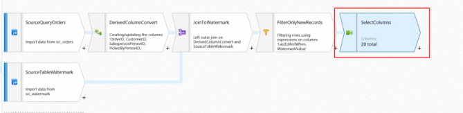

    Hello @Neal Lockhart, Can you try the below ADF dataflow for incremental load User's image
    To support incremental data loading, we create a table to store the watermark values for each source table. This watermark table includes the following columns:
    • WatermarkTableName: The name of the source table.
    • WatermarkColumn: The name of the column used as the watermark (e.g., a timestamp or incremental ID).
    • WatermarkValue: The last processed value of the watermark column.
    Watermark Table
    `CREATE TABLE [dbo].[WatermarkTable] (`
    NULL,
    NULL,
    NULL
    ) ON [PRIMARY];
    GO
    Insert Initial Watermark Record
    Next, insert the initial watermark record into the WatermarkTable. This entry should include the name of the source table, the column used for tracking changes (e.g., a timestamp or ID), and the last loaded value. This insert is a one-time setup—moving forward, the WatermarkValue will be updated after each incremental load.
    In this case, the table will contain the following record:

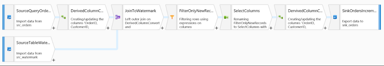

    In this Data Flow, we aim to include only the records from the source table or query where the value is greater than the previously stored watermark value. This ensures that only new or updated data since the last load is processed.
    Source 1
    In the source and click on "Source Options". Select "Query" and write the query. Click on "Import Schema" and at last we can preview data.

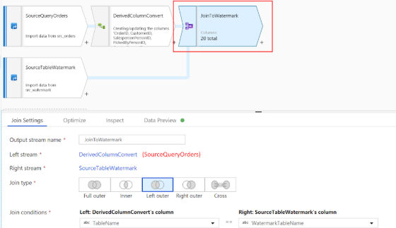

    Source 2: watermark table
    This source uses a simple query to retrieve data from the WatermarkTable. The configuration is similar to Source 1, but with a different query. Later, we can refine this by ensuring that only the relevant watermark value for the specific table is selected—using a join to match the correct table in the WatermarkTable.
    SELECT
    [WatermarkTableName]
    , [WatermarkColumn]
    , [WatermarkValue]
    FROM [dbo].[WatermarkTable]

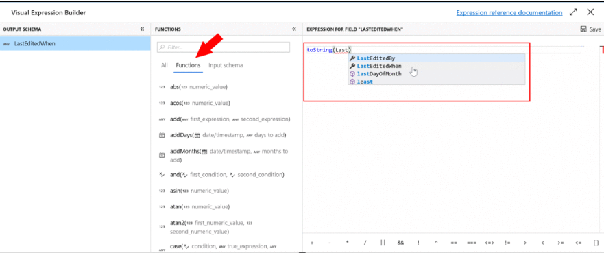

    Use Derived Column:
    Watermark values can have different data types, which is why we store them as nvarchar in the WatermarkTable. In this case, the watermark is of type datetime, so we need to convert it appropriately to ensure a successful join with the watermark table. This conversion is handled using the expression language within Mapping Data Flow.
    Use Join Transformation:
    To combine data from different sources, we use a join operation. Options include 'Full Outer', 'Inner', 'Left Outer', 'Right Outer', or 'Cross' join. In this scenario, we want to ensure the correct watermark value is applied for the incremental load of a specific table. We're using a Left Outer Join, but an Inner Join would also work since all records refer to the same table. However, joining on the table name from the watermark table is a more future-proof approach—relying on a join based solely on the watermark column could lead to issues when multiple tables share the same watermark column name.

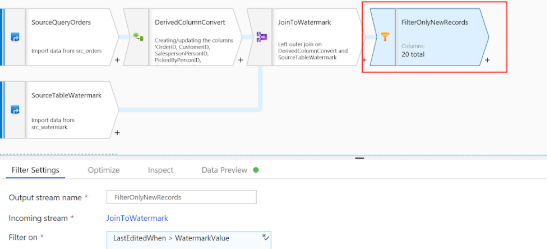

    Use Filter Transformation:
    Since the "Join" transformation in Data Flow only allows joining on columns with equal values, we use a "Filter" transformation afterward to include only the records where the value from the source table or query is greater than the latest watermark value.
    Use Select Transformation:
    Here we have to use the "Select" component to select the relevant columns.

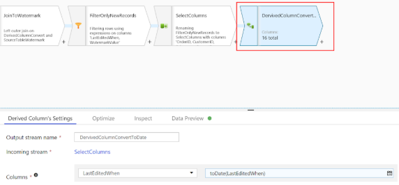

    Use Derived Column 2 Transformation:
    Before configuring the destination, we add a new "Derived Column" transformation to convert the LastEditedWhen column back to a date. This step is necessary to ensure proper mapping with the Orders_Incremental table, as it follows the original schema of the Orders table, where the LastEditedWhen column is defined with a date/time data type.
    Use Sink
    In Azure Data Factory (ADF), the destination is referred to as a "Sink". In this step, we select our target table named Orders_Incremental, which shares the same schema as the original Orders table. After creating the Sink dataset, the columns will be mapped automatically. If needed, you can disable Auto Mapping to manually configure the column mappings.
    Update Watermark
    Finally, we need to update the watermark value to reflect the most recent value—in this case, the latest LastEditedWhen date. To accomplish this, we’ll use a simple stored procedure that performs the update.
    sql
    CREATE PROCEDURE [dbo].[usp_UpdateWatermark]
    @tableName nvarchar(255)
    AS
    BEGIN
    DECLARE
    @watermarkValue nvarchar(255)
    SELECT
    @watermarkValue = MAX([LastEditedWhen])
    FROM [Sales].[Orders_Incremental] AS T
    UPDATE [dbo].[WatermarkTable]
    SET [WatermarkValue] = @watermarkValue
    WHERE [WatermarkTableName] = @tableName
    END
    GO
