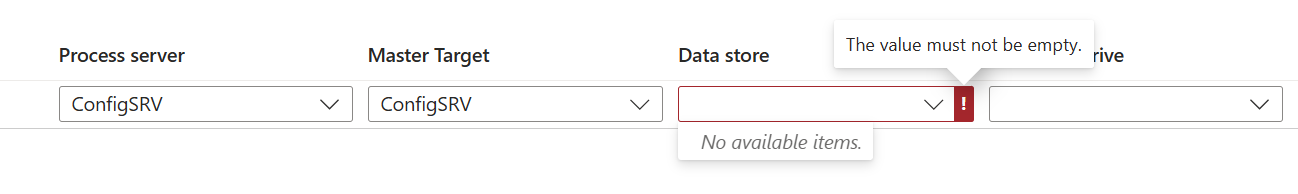

I’m currently facing an issue with Azure Site Recovery (ASR). I performed a failover to Azure, but did not commit. I now need to fail back to my on-premises VMware environment. However, when I try to perform a Re-Protect, the on-premises datastore is not appearing in the options.
Additionally, I currently do not have a Site-to-Site VPN or ExpressRoute connection active between Azure and my on-premises environment, which may be contributing to the problem.
Could you please advise on how I can:
  1. Fail back to VMware without a Site-to-Site VPN.
  2. Make the on-premises datastore visible in the Re-Protect step.
  3. Understand whether I need to commit the failover first or can still go back without data loss.

    1. You should NOT commit the failover if you plan to fail back.
    2. Committing destroys recovery points in Azure.
    3. You're fine — since the failover is not committed, the recovery points are still usable for failback.
    To fail back safely, you should:
    Re-establish a Site-to-Site VPN or ExpressRoute between your Azure VNet and on-premises network.
    Once network connectivity is restored:
    The on-prem Configuration Server will be contactable.
      You can proceed to **Re-Protect** and **Failback** to VMware.
         The **datastore will become visible** in the wizard.
    This is the recommended and supported approach.
