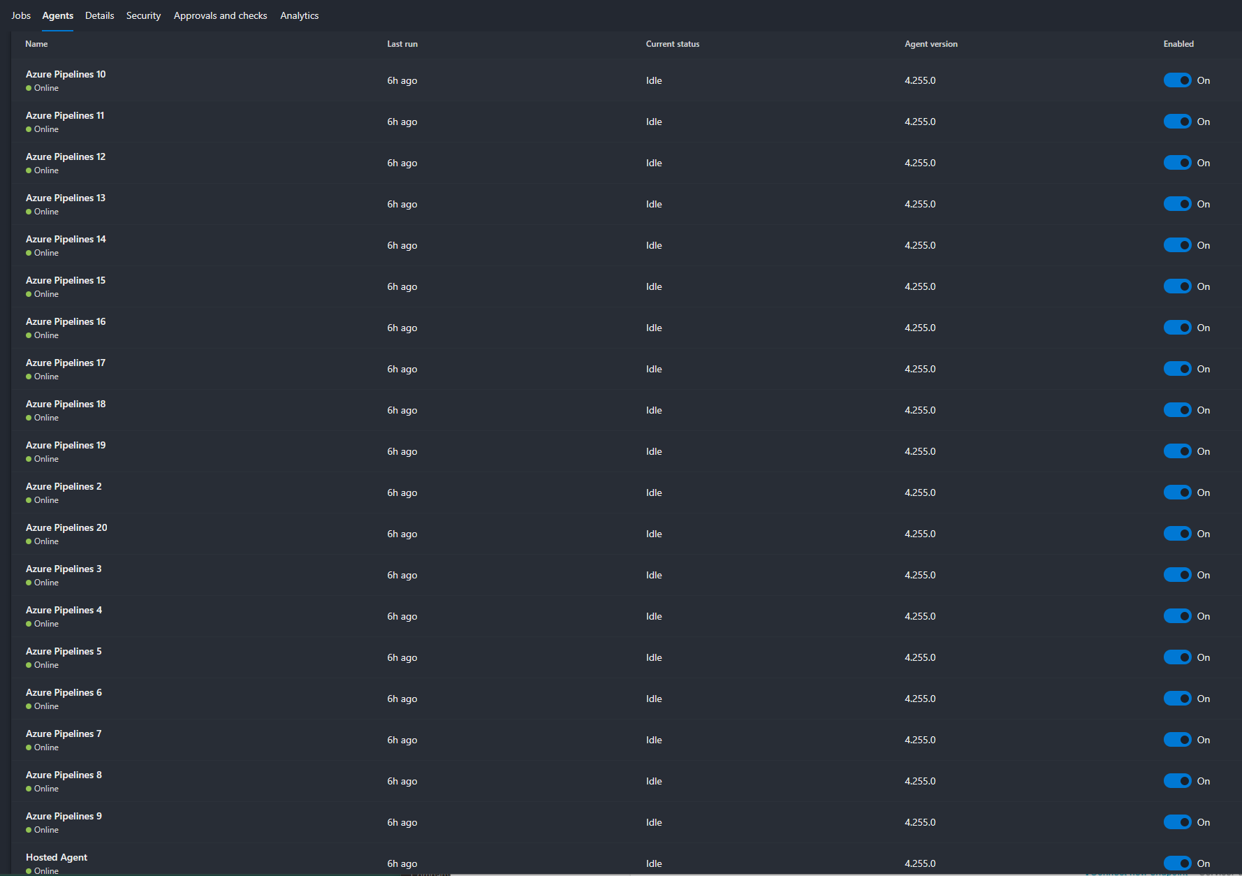

This morning I discovered that we had 48 build pipelines that had been waiting for a hosted agent for more than five hours.
The jobs were stuck with the following message:
"This agent request is not running yet. Current position in queue: 1. Current parallelism: 0. Max Parallelism for parallelism type 'Microsoft-Hosted Private': 20"
I have tried cancelling all the jobs, and started a new, but it doesn't get an agent assigned.
I have also tried disabling all of the 20 agents, and enabling them again. But it doesn't make any difference.
We have no jobs that have been running since midnight, so it seems like an issue with the Microsoft hosted agents.

    Morten Jensen, I completely understand how frustrating it can be to see dozens of build pipelines stuck in queue for hours on end, especially when everything looks online and there does not appear to be any obvious reason. What happened here is not a mistake on your part. In fact, Azure’s shared pool of Microsoft-hosted VMs in your region was fully booked by other teams across DevOps, which meant none of your queued pipelines could start until more capacity became available. Once Azure added additional VMs around 9:10 AM, all your pipelines immediately began running.
    When you navigate to Organization Settings and look under Pipelines › Parallel jobs › Microsoft-hosted, you might see that your “In use” count falls below the “Total” slots allocated to your account. That can be misleading, because Azure DevOps does not instantly provision a new VM whenever a slot is technically available. During peak demand, every VM in that pool may already be in use by other customers, so even if your project is not actively consuming all its slots, your build will remain queued until Microsoft brings additional VMs online.
