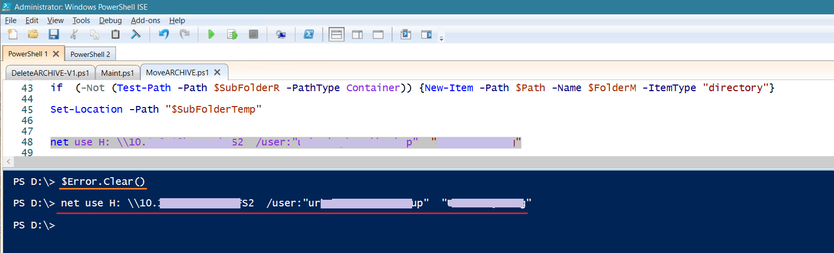

  1. I try to map a disk in PS using the right user name and password:
    01

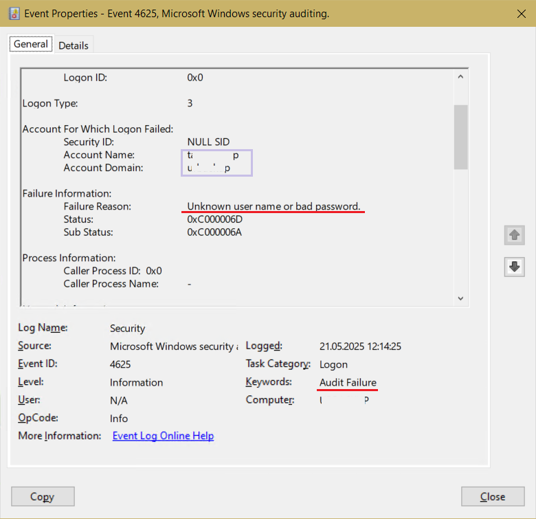

2 The disk does not map and the following event gets registered on the server containing the share:
02

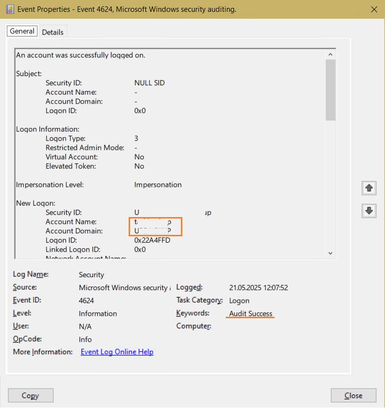

4 The event 4624 (success) with the same credentials:
05
Q1: What does it mean???

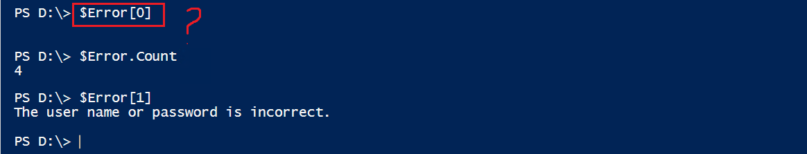

And one more problem that I see only in the cases described above: I always use error checking when running some commands and in case the error arises I use something like
Error.Clear
COMMAND
Write-Output "..... the error was $Error[0].Exception.Message"
-but in these cases the $Error[0] is always empty, the first error is in the $Error[1]:
03
Q2: Why?

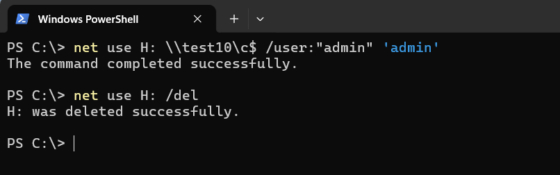

    Do you have any special characters, like dollar signs, in the password? Powershell may be trying to interpret them instead of just passing them on to net.exe.
    Try putting single quotes around the password.
    net use H: \\test10\c$ /user:"admin" 'admin'
    net use H: /del

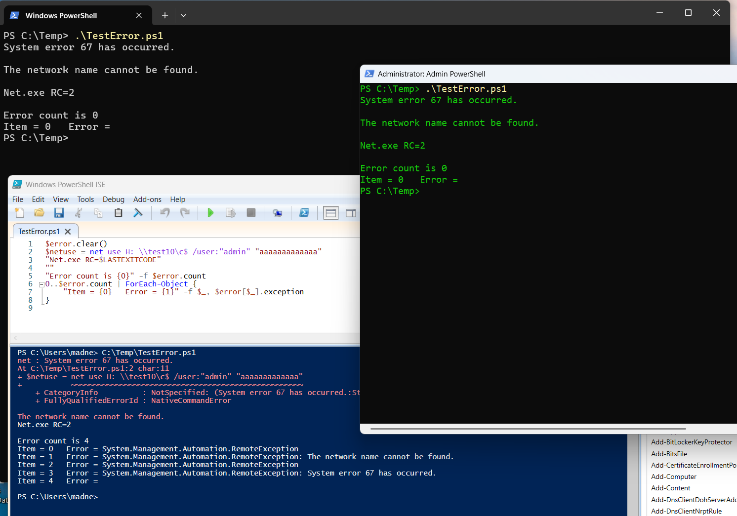

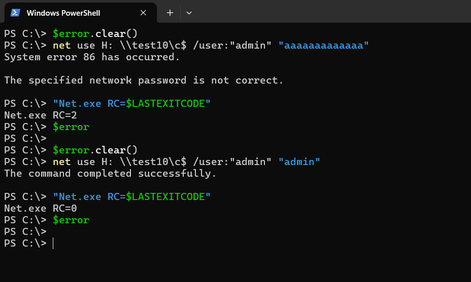

    Net.exe doesn't know anything about Powershell error variables. You need to check $LASTEXITCODE.
    $error.clear()
    net use H: \\test10\c$ /user:"admin" "aaaaaaaaaaaaa"
    "Net.exe RC=$LASTEXITCODE"
    $error
    $error.clear()
    net use H: \\test10\c$ /user:"admin" "admin"
    $error
    If you want to reference $error, then use the Powershell cmdlets instead of net.exe.
    $User = ".\admin"
    $PWord = ConvertTo-SecureString -String "admin" -AsPlainText -Force
    $Cred = New-Object -TypeName System.Management.Automation.PSCredential -ArgumentList $User, $PWord
    New-PSDrive H -PSProvider FileSystem -Root "\\test10\c$" -Credential $cred  -persist
    remove-psdrive H
    $error.clear()
    $User = ".\admin"
    $PWord = ConvertTo-SecureString -String "aaaaaaaaaaaaa" -AsPlainText -Force
    $error[0]
    $error[1]

    MotoX80, yes, that's it!!!
    "net use H: \test10\c$ /user:"admin" 'admin' - single quotes do really work - thanks a lot (yes, there was $ in the password)!!!
    Regarding the $Error:
    1. thank you for the net.exe's replacement
    2. if Net.exe doesn't know anything about Powershell error variables then why the $Error[1] (instead of $Error[0]) does return the correct error???
