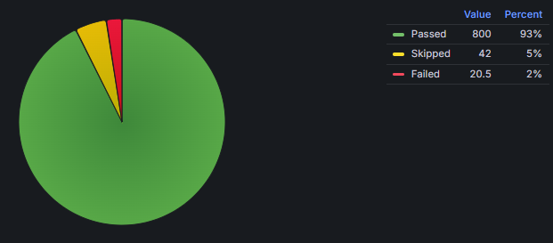

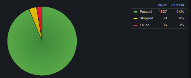

When I change the Resolution on my pie chart, it changes the totals for my segments. For example, a resolution of 2m creates the below graph (with Passed = 1337, Skipped = 50, Failed = 36):
but a resolution of 1m creates the below graph:
When investigating this discrepancy, I realised that if I was looking at the Table View, and ran the query with Resolution at 1m, then switched to the Pie Chart, it would show the values of resolution at 2m (Passed = 1337, Skipped = 50 and Failed = 36). If I ran the query again, in the Pie Chart view, this would change back to the 1m view (Passed = 800 etc).

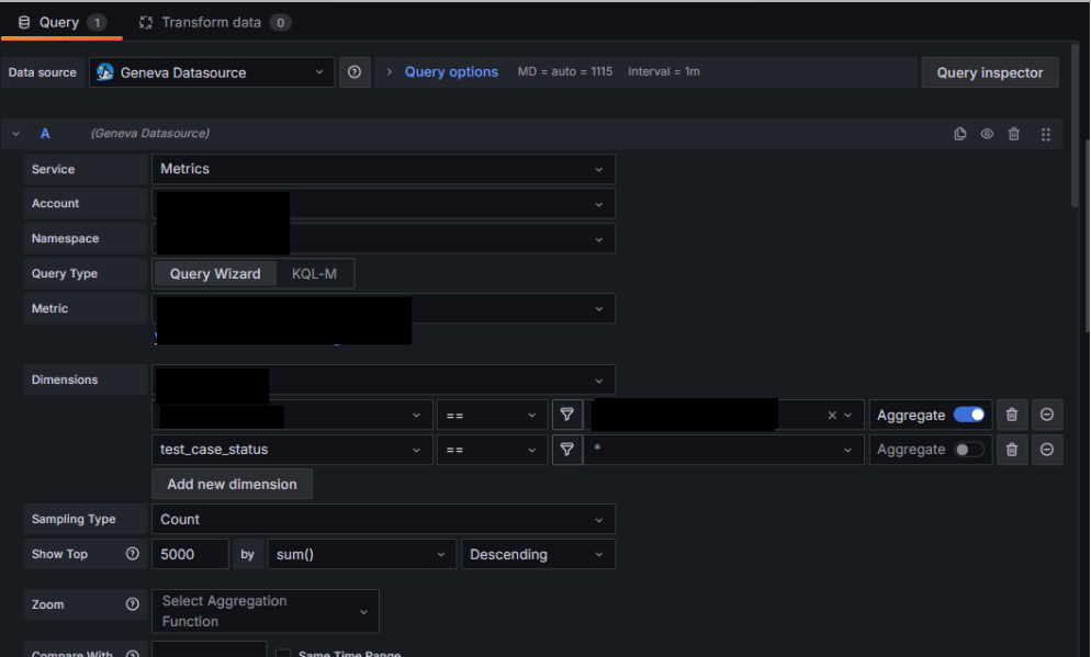

I am using a Geneva Datasource, with the service set to Metrics. I have a pie chart that aggregates on every dimension of the metric except status, which can be passed, failed or skipped.User's image
My sampling type is Count, I have Show Top set to 5000 by Sum and no Zoom aggregation function.

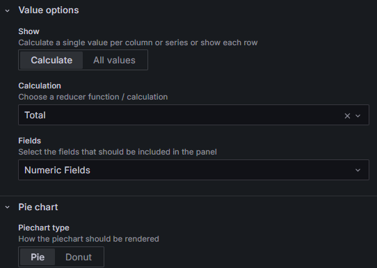

I see the same behaviour regardless of whether I have Value Options set to Calculate Total:User's image

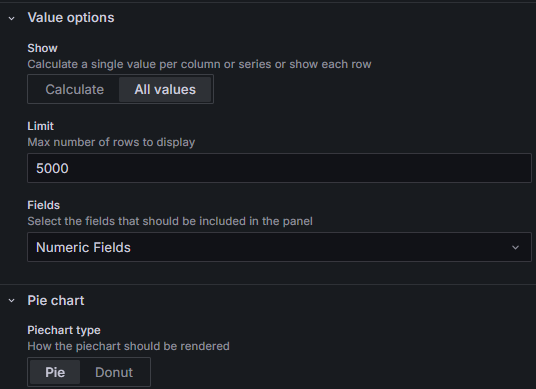

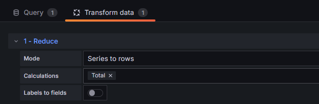

or Value Options set to All Values, with a 5000 limit, and a Reduce Transformation for Series to Rows and Total
User's imageUser's image
