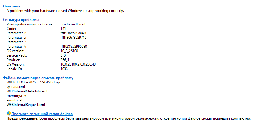

After turning on the computer, after some time the picture freezes, there is no blue screen. Regardless of whether the game is on or not and whether there is any load. After looking at the log log, it says that the computer was shut down due to hardware error. All logs attached in the message. After rebooting does not help, everything happens again and again

    Hello, Ivan Ivanich
    Thanks for sharing the screenshot. Based on the information provided, the issue you're encountering is a Live Kernel Event with code 141, specifically:
    Event: LiveKernelEvent
    Code: 141
    ⚠️ What does this mean?
    LiveKernelEvent 141 is typically associated with GPU-related hardware or driver issues. This kind of error usually occurs without a blue screen and often causes:
    • System freezing
    • Black screen
    • Automatic reboots or shutdowns
    ```🔍 Key Indicators from Your Log
    ```yaml
    • Error Code: 141 → Often tied to TDR (Timeout Detection and Recovery) failures.
    • File listed: WATCHDOG-*.dmp → Suggests a watchdog timeout was detected.
    • No obvious trigger → Indicates it could be temperature, PSU, GPU hardware, or driver-related.
