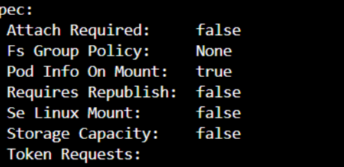

    And then Edit the CSI driver using the command below to change fsGroupPolicy to None. Once applied, as shown in the screenshot, it should work as expected. changes was applied on the open source csi driver

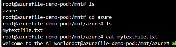

    After modifying the CSI driver, recreate or update the PVC and PV YAML files in the same way as you initially did for the Azure-managed version. Deploy the cluster and, once the pod is running, verify that you can see the mounted storage files within the pod. If you can access the files from the pod, the setup is working correctly. after the above steps I have check in my lab I'm able to see the mount storage file from pod as shown below screenshot

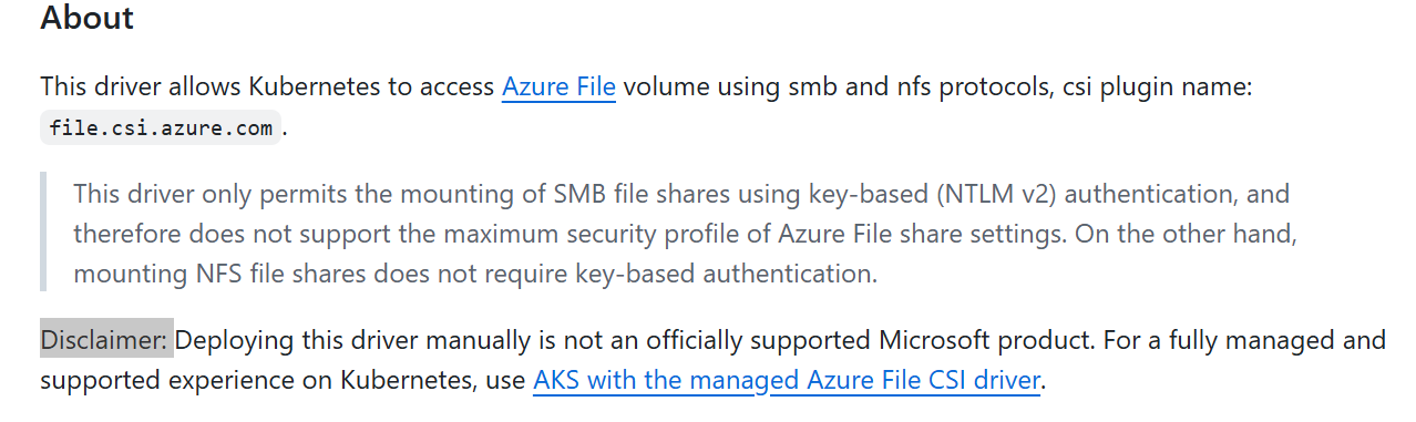

    If you face any issues for deploying this driver manually is not an officially supported Microsoft product. For a fully managed and supported Kubernetes experience, use AKS with the Azure-managed File CSI driver. Screenshot for your reference
    Please refer the below documentation for more information
    https://github.com/kubernetes-sigs/azurefile-csi-driver
