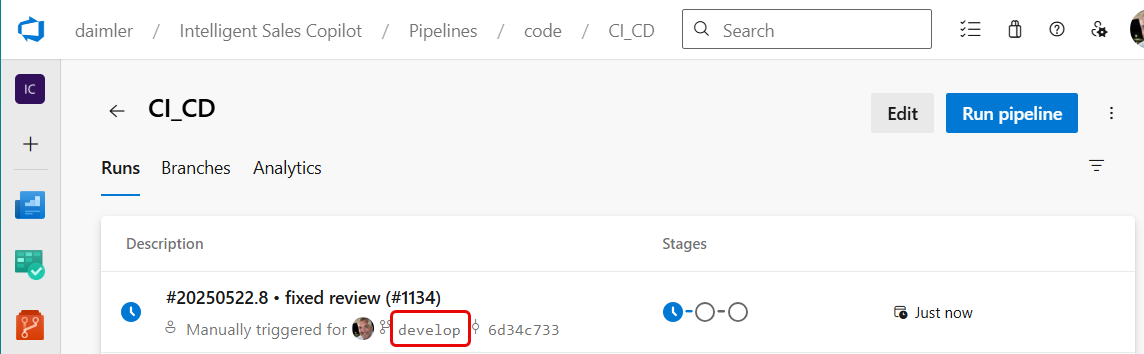

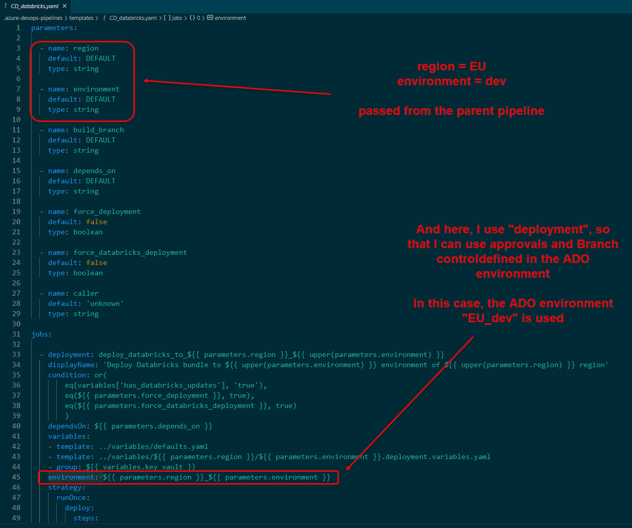

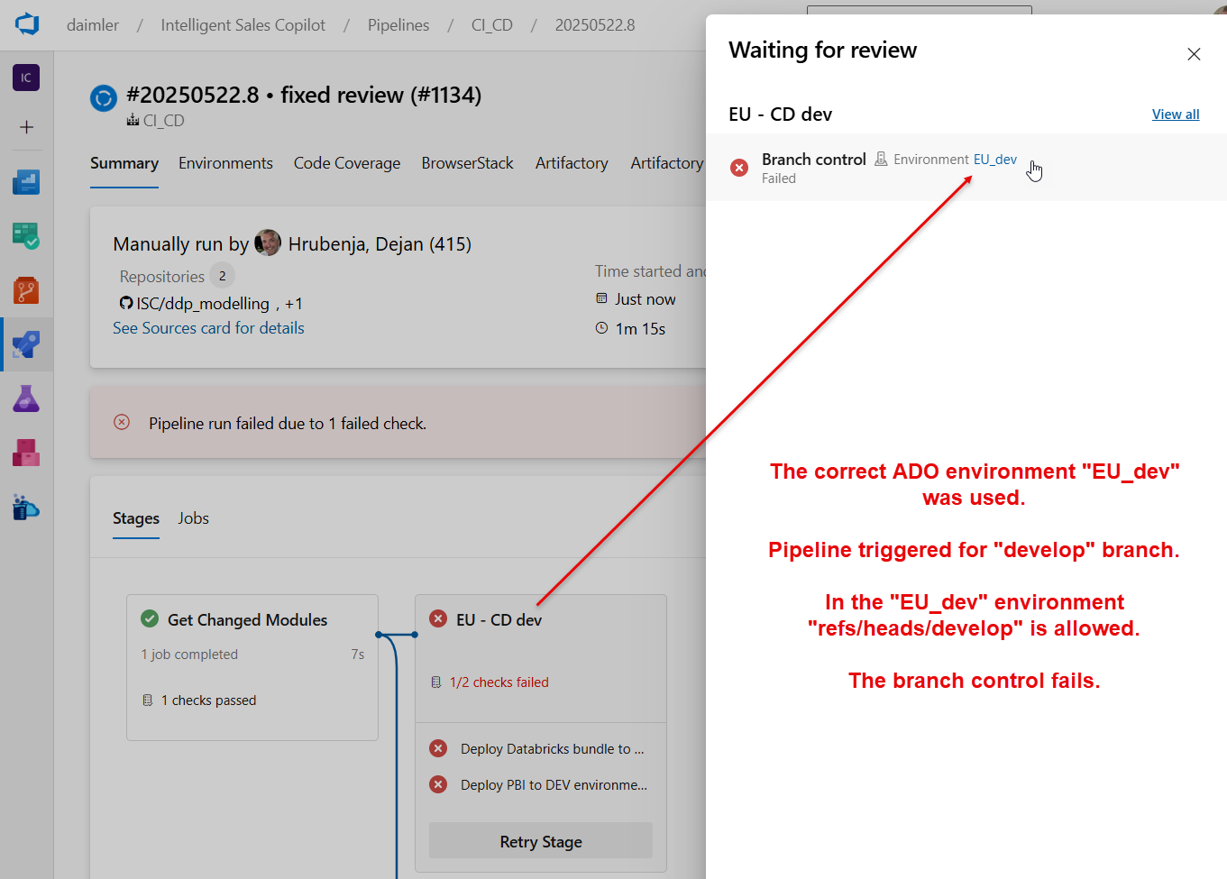

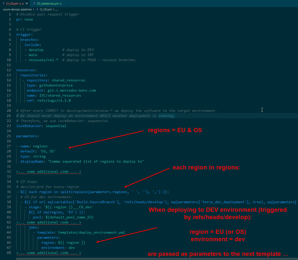

We use YAML pipelines. In our deployment jobs, we reference Azure DevOps environments. In ADO environments, we defined Branch control rules. E.g. refs/head/main is allowed in the ADO environment EU_int . If the YAML pipeline is triggered by the main branch , the run is allowed. If I execute the same pipeline with another branch, Azure DevOps reports "Branch control failed". It worked well for months. And suddenly stopped to work. We didn't change anything. The pipeline is triggered by the main, the correct ADO environment EU_int is used (refs/head/main is allowed there), and we gett "Branch control failed"
