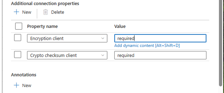

How to get the new data factory oracle 2.0 connector to connect?
We currently connect to oracle using the 1.0 connector.
We must be moved to the new oracle 2.0 connector before end of support, 7/31/25.
I was able to get this to connect to a non encrypted database, but unable to connect to an encrypted database.
I had to add encryption client and crypto checksum client to get this to connect to our non encrypted dev.
Those changes will not work for production.
For dev, I used "accepted" for both.
For prod, i tried both accepted and required
Azure Data Factory

The Oracle 2.0 connector in Azure Data Factory does enforce stricter security protocols compared to the legacy 1.0 connector, especially when connecting to encrypted Oracle databases.For encrypted databases, specifying the following under Additional connection properties is necessary:
Encryption client = required
Crypto checksum client = required
However, if your production Oracle instance is not configured to require encryption (but only accepts it), setting both to
required
can lead to failures. In such cases, please try:-
Encryption client = accepted

2025-05-22T14:47:54.64+00:00 Here is what the production server has in the sqlnet.ora
SQLNET.ENCRYPTION_SERVER=REQUIRED
SQLNET.ENCRYPTION_TYPES_SERVER=(AES128,AES256,AES192) SQLNET.CRYPTO_CHECKSUM_SERVER = REQUIRED
SQLNET.CRYPTO_CHECKSUM_TYPES_SERVER=(SHA1,SHA256)
sqlnet.encryption_client=REQUIRED
sqlnet.encryption_types_client=(AES128,AES256,AES192)
SQLNET.CRYPTO_CHECKSUM_CLIENT = REQUIRED
sqlnet.crypto_checksum_types_client=(SHA1,SHA256)
That is the reason I tried required and required. Upper and lower case.
This is the error i get when both are set to required.
Test connection operation failed.
Failed to open the Oracle database connection.
ORA-50201: Oracle Communication: Failed to connect to server or failed to parse connect string
ORA-12650: No common encryption or data integrity algorithm
