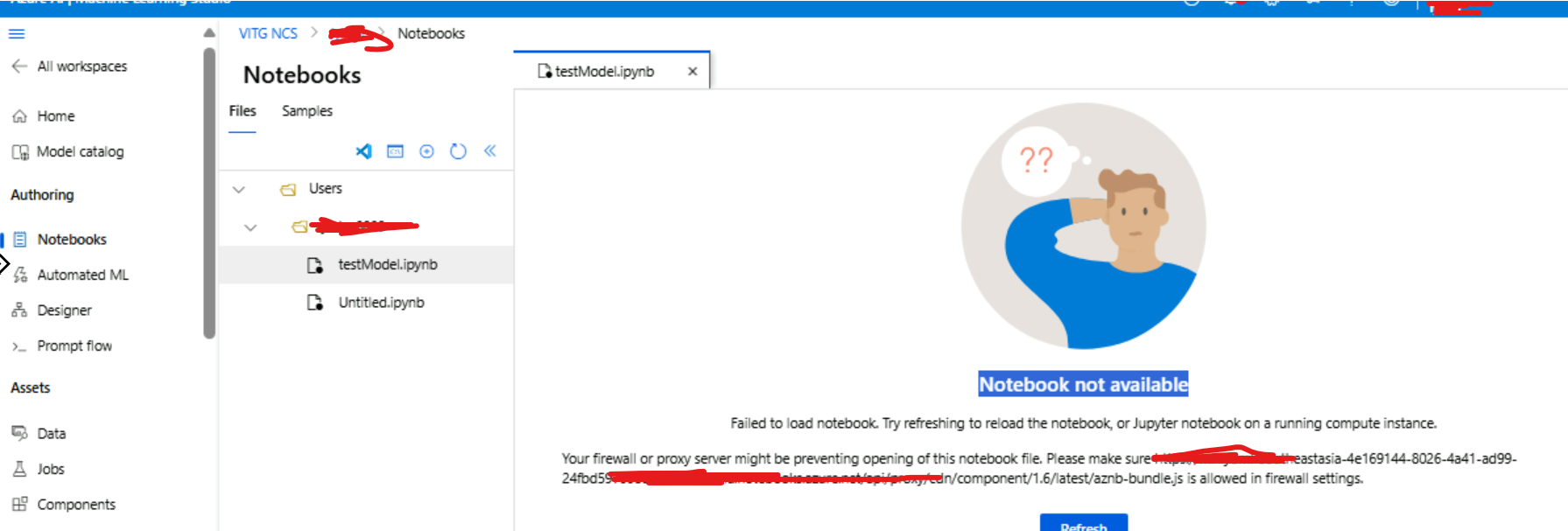

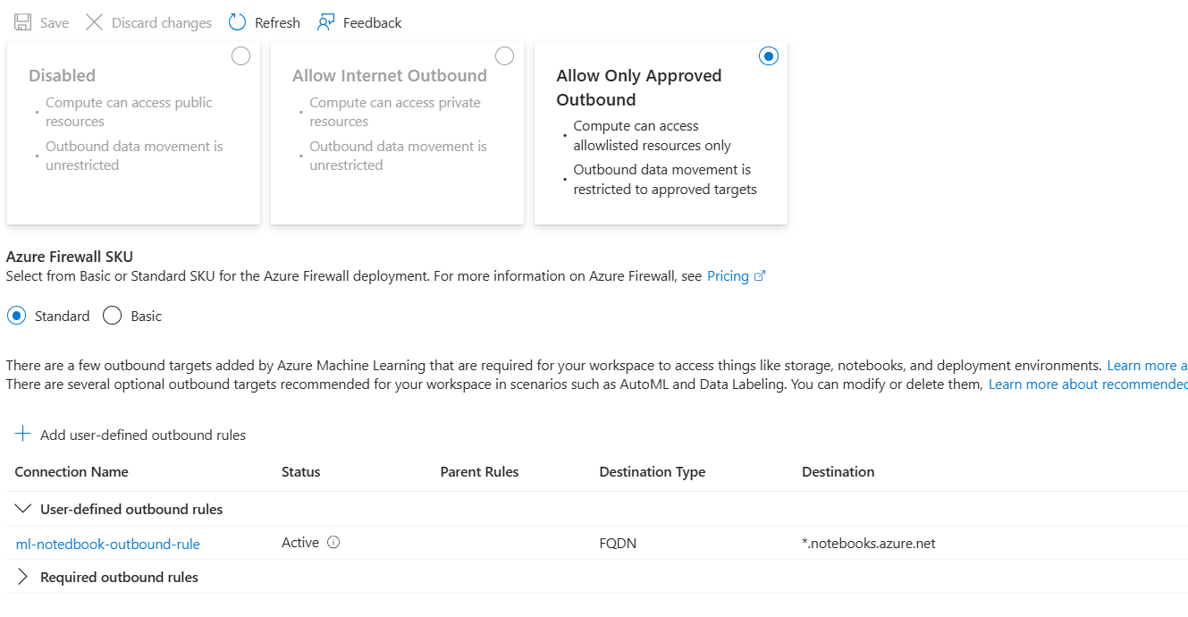

I created an Azure Machine Learning workspace, disabled public access, and set the outbound policy to "Allow Only Approved Outbound". Then I was unable to open notebooks in the ML workspace.
Even I added a FQDN, it is still failed.

    You're encountering issues with Azure Machine Learning Notebooks becoming inaccessible when using the "Allow Only Approved Outbound" option. This behavior is expected based on how AzureML’s network isolation works.
    When you enable “Allow Only Approved Outbound”:
    • Azure restricts outbound internet access to only Microsoft-approved FQDNs.
    AML notebook compute relies on access to multiple Azure services like identity, storage, blob access, and telemetry.
    • If any of these required domains are blocked or missing, the notebooks will fail to launch or function correctly. Adding just one or two FQDNs manually is not sufficient, because many services resolve to multiple dynamic subdomains and IPs.

    1. Use “User-Defined Routes (UDR)” + Approved FQDN Tags
    Microsoft provides a list of required FQDNs that must be whitelisted when using "Approved Outbound" mode.
    Please ensure the following are allowed in your Firewall, NSG, or routing setup:
    Required FQDNs
    *.notebooks.azure.net
    *.pythonhosted.org
    *.pypi.org
    *.blob.core.windows.net
    *.azureml.ms
    *.microsoftonline.com
    *.login.microsoftonline.com
    *.aznbcontent.net
    *.experiments.azureml.net (region-specific)
    Reference: Approved FQDNs for Notebooks and Compute

    Can you please try below the workaround solution which would resolve your issue
    1. Change the Outbound Access Mode to "Allow All" temporarily.
    2. Verify notebook access.
    3. Once confirmed, revert to secure mode with proper FQDN whitelisting.

    Are you accessing the notebook via a Jumphost in the same VNet as the private endpoint for the workspace? If yes, then make sure your private endpoint for the workspace and DNS settings in your VNet are correctly set up.
    If not, you will need to allow internet inbound and set an inbound IP rule to your client IP. I don't think outbound policies are the issue here as those are for compute services in the managed VNet initiating outbound requests. Here, you are attempting to access the workspace (inbound) as a client.
