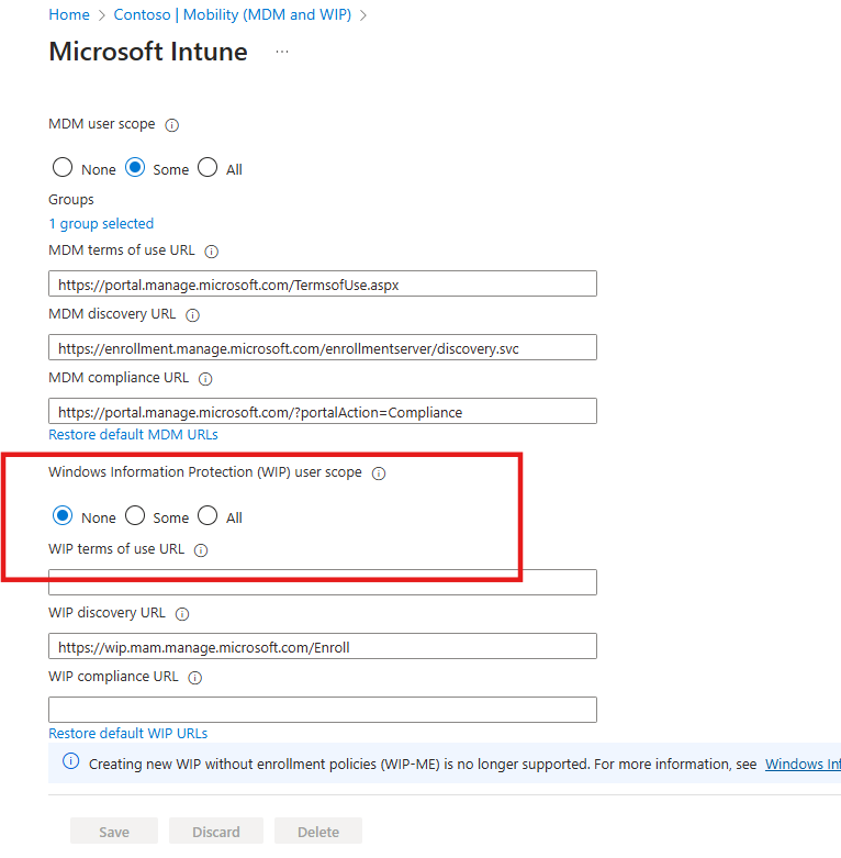

    Check Windows Information Protection (WIP) Settings:
    1. Go to portal.azure.com.
    2. Navigate to Microsoft Entra ID > Mobility (MDM and WIP) > Microsoft Intune.
    3. Set the Windows Information Protection (WIP) user scope to "None".

    Verify Windows Information Protection (WIP) Settings:
    Open the Azure Portal.
    Locate the Windows Information Protection (WIP) user scope setting and change it to None.
    Note: Changing the settings in the Azure Portal requires Global Administrator or Intune Administrator privileges.
