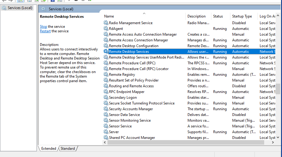

  1. Service State:
    • TermService and UmRdpService are both running.
    • RDP listener RDP-Tcp is present in the registry.

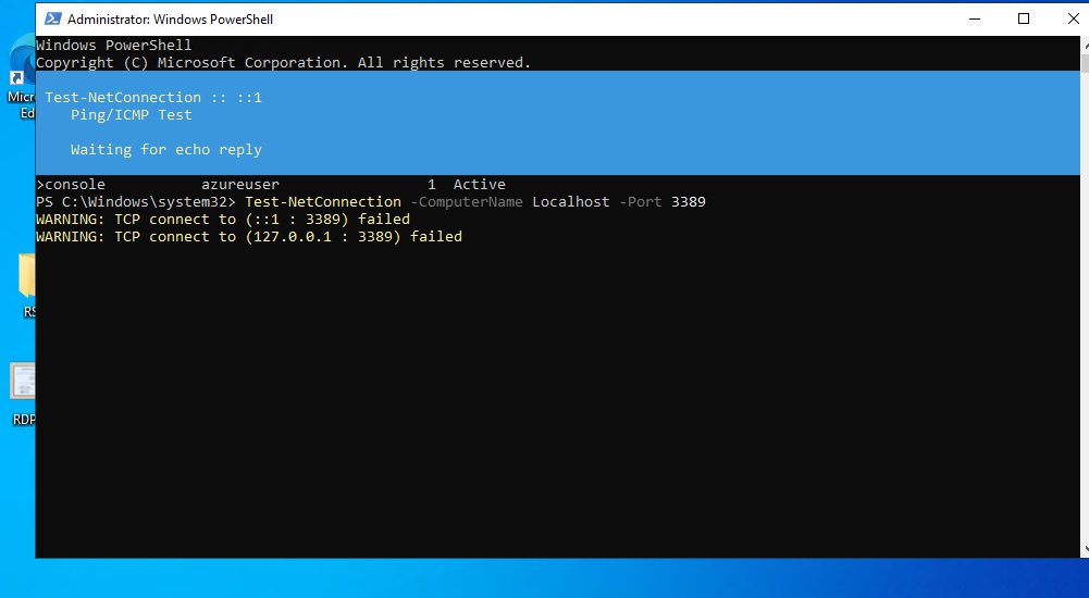

  3. Port Binding Failure:
    • netstat -an | findstr ":3389" returns nothing — port 3389 is not bound.
    • Test-NetConnection -ComputerName localhost -Port 3389 fails.
    • Get-NetTCPConnection -LocalPort 3389 shows no bindings.
    • No events in the System/EventLog clearly identify binding failure.

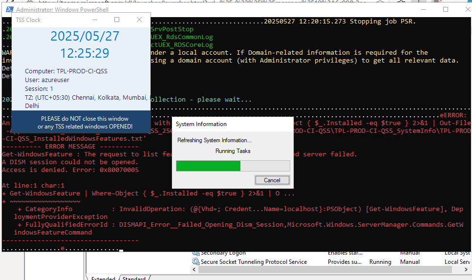

  8. Verified that no RDS licensing misconfigurations, GPOs, or RDS role services were blocking listener registration.
  9. Ran DISM and CBS scans – no errors affecting RDP functionality found.

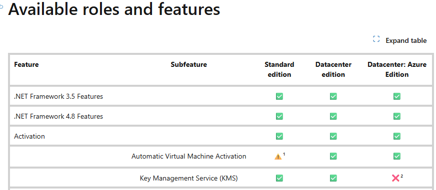

  2. Are there RDP/SSL binding constraints specific to Azure Edition v2 images, especially when not running in Azure?
  3. Are there additional certificate requirements (e.g., from IMDS or Windows Activation Services) that block listener registration?
