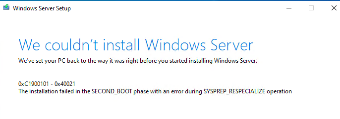

Trying to upgrade server from 2022 to 2025 and am getting this error. Nothing in the event logs. it is a Hyper-V VM but no problems upgrading other VMs. Any help would be greatly appreciated. Thanks

    This error is occurring during the second boot phase (SYSPREP/re-specialization), which indicates the VM is failing while attempting to reconfigure system settings post-upgrade. Since other VMs are upgrading successfully, the issue is likely related to this particular VM’s configuration or environment.

    2025-07-14T17:35:27.75+00:00
