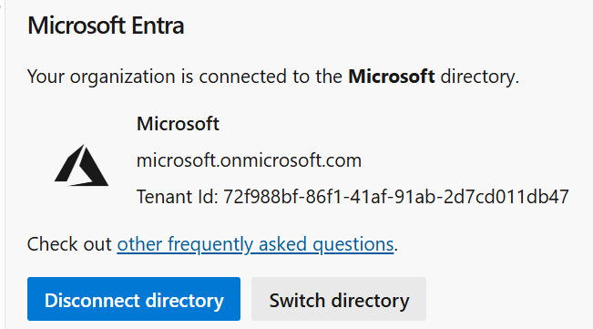

    4. Since you mentioned that the Azure DevOps organization is under a different directory (camsolutions.ca) and the Azure subscription is in (lruivocsiflex.onmicrosoft.com), this could be causing the issue. You need to switch Azure DevOps to the correct Azure AD tenant or directory.
    5. Go to Azure DevOps Organizations -> Organization Settings -> Microsoft Entra ID -> Check if the correct directory is linked. User's image
