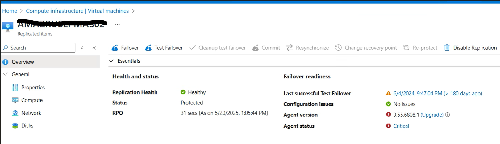

    To address this firstly navigate to your VM in the Azure portal and verify the replication health and agent status as shown below. User's image

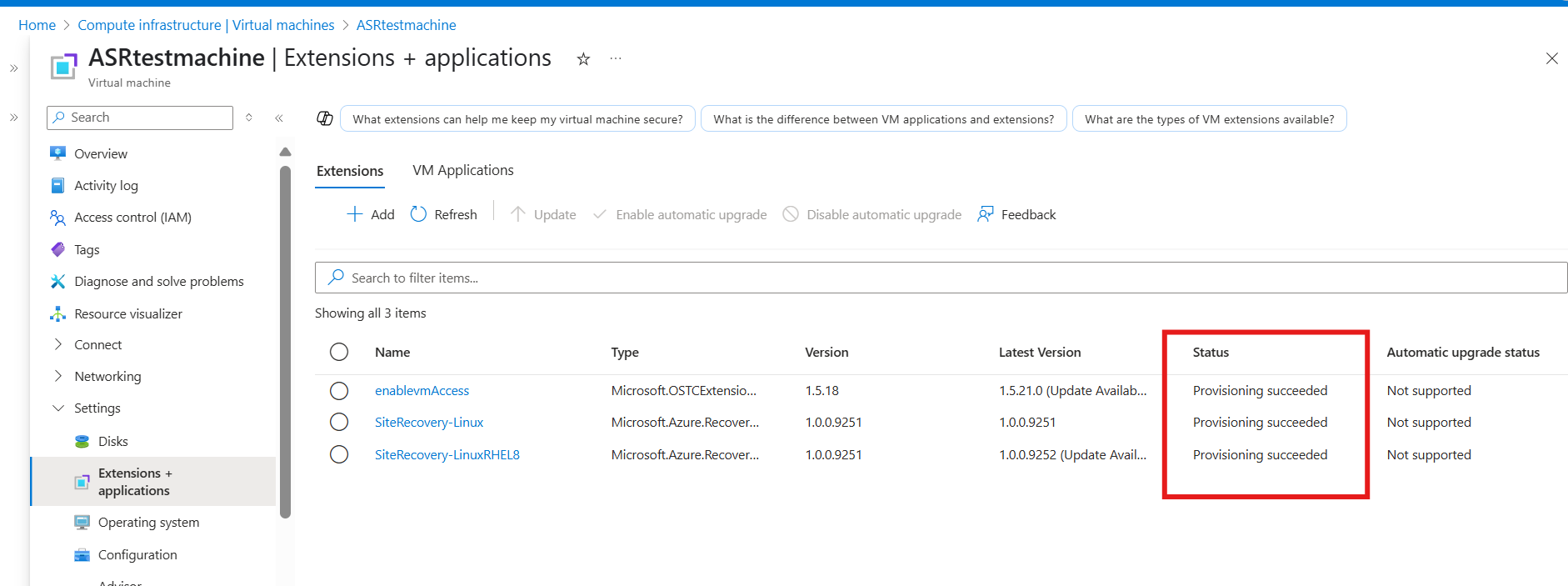

    And go to the Extensions + applications blade of the VM and check the status of all extensions.
    • If any extension is in a Failed state, ensure its Provisioning State is set to Succeeded before proceeding. User's image
