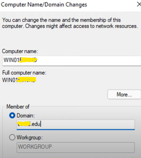

    3.Check Domain Trust Relationships:
    • Ensure the workstation is properly joined to the domain and that trust relationships between the domain controller and the workstation are intact.

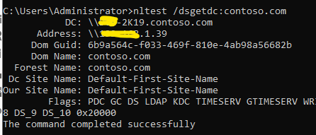

    5.Verify Domain Controller Connectivity:
    • To confirm the workstation is communicating with the correct domain controller by running the command. nltest /dsgetdc:<domain name> User's image
