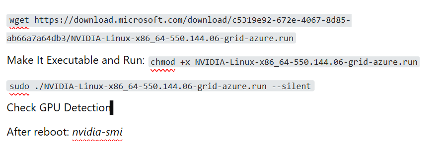

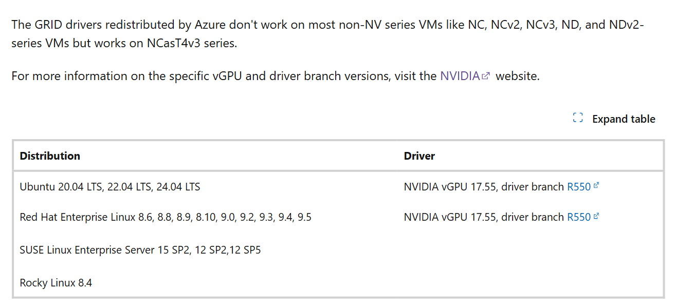

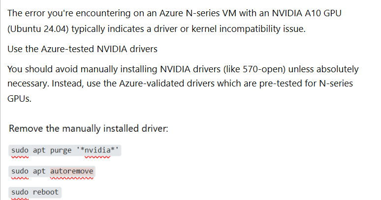

  1. Mounika Reddy Anumandla 6,940 Reputation points Microsoft External Staff Moderator
    2025-05-29T08:54:24.5266667+00:00
    Hi Rohil Tamzid,User's image
    User's imageUser's image
    As suggested by Deepanshukatara-6769 the below document gives clear information and details on how to install the GRID Drivers!
    https://learn.microsoft.com/en-us/azure/virtual-machines/linux/n-series-driver-setup
    https://forums.developer.nvidia.com/t/installing-nvidia-drivers-cuda-on-azure-nvadsa10-v5-vm-ubuntu-22-04/321128/3
    Hope it helps!
    Let me know if you have any further queries!
