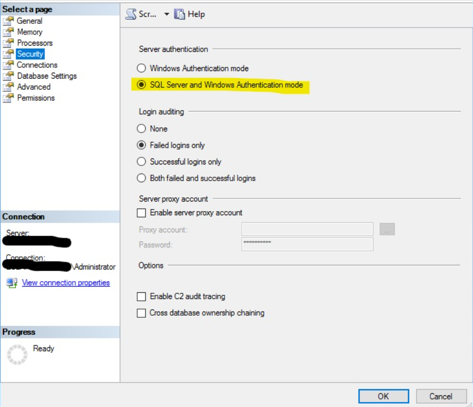

    change the Server Properties-->Security-->Server authentication from
    Windows Authentication mode to
    SQL Server and Windows Authentication mode.
