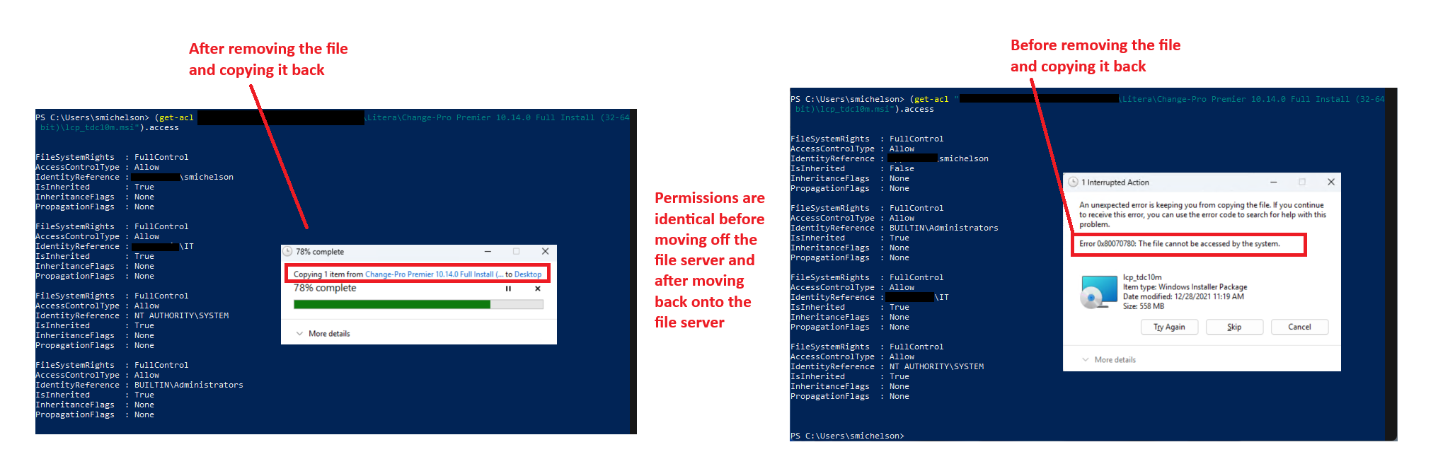

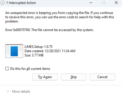

I have full access to the files at the HostFolder location above using my regular Windows workstation, but when accessing the same files using the Sandbox running on the same workstation, I'm only able to access some files and not others:
I have found that if I take one of these problem files, move it off the file server using my regular workstation, then copy it back to its previous location, I am then able to access the file from the Sandbox when previously I could not.
As a test, I checked the ACL permissions of one of these problem files before moving it off the file server, then I checked the permissions again after moving it off and copying it back, and the permissions are identical (unchanged from before and after being moved):
User's image In screenshots above, I was unable to access the file from the Sandbox before moving it off the file server, and was only able to access it after copying it back to the server, even though the ACL permissions are unchanged before the move and after.
Looking for some ideas/suggestions as to what is happening here?
