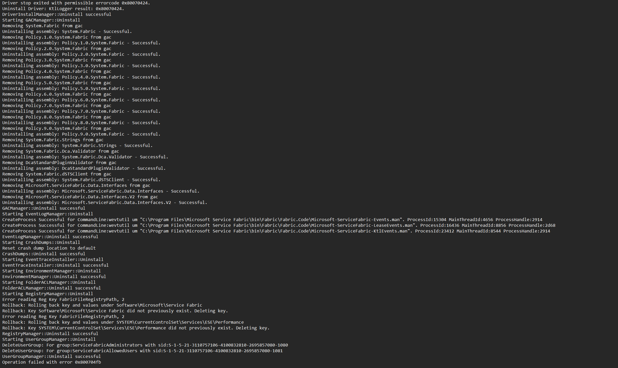

The linked log shows: Screenshot 2025-05-29 184435
I've also tried running: & 'C:\Program Files\Microsoft Service Fabric\bin\Fabric\Fabric.Code\InstallFabric.ps1' -FabricRootIsPreInstalled -AcceptEULA
The script runs but fails during the driver installation phase with the following error:
Error 0x800704fb while installing driver LeaseLayer
DriverInstallManager::Install failed with error 0x800704fb
This error appears to correspond to: “A system shutdown is in progress.”

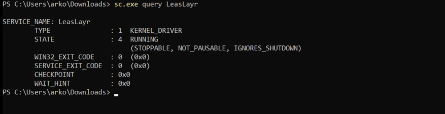

  2. Arko 4,150 Reputation points Microsoft External Staff Moderator
    2025-05-30T04:59:25.4566667+00:00
    Hello Jania, I believe you are trying to install this on your office MS imaged laptop and it has a corporate policy enabled and that is the blocker. From the installation logs and error messages, the issue seems to stem from Memory Integrity (Core Isolation) being enabled and locked via Group Policy, which blocks the LeasLayr.sys driver from loading. The machine has Memory Integrity (Core Isolation) enabled, and it's locked via Group Policy (This setting is managed by your administrator). As a result, Windows is blocking the Service Fabric kernel driver LeasLayr.sys from loading — which causes the installation to fail.
    On your laptop, if you go to windows security-> core isolation -> you will memory integrity is on
    If you spin up a windows VM free from these corporate restrictions on Azure, you will see it is working fine. If you want you can even test it out on your personal laptop. It will work.
    ps1
    ps2
