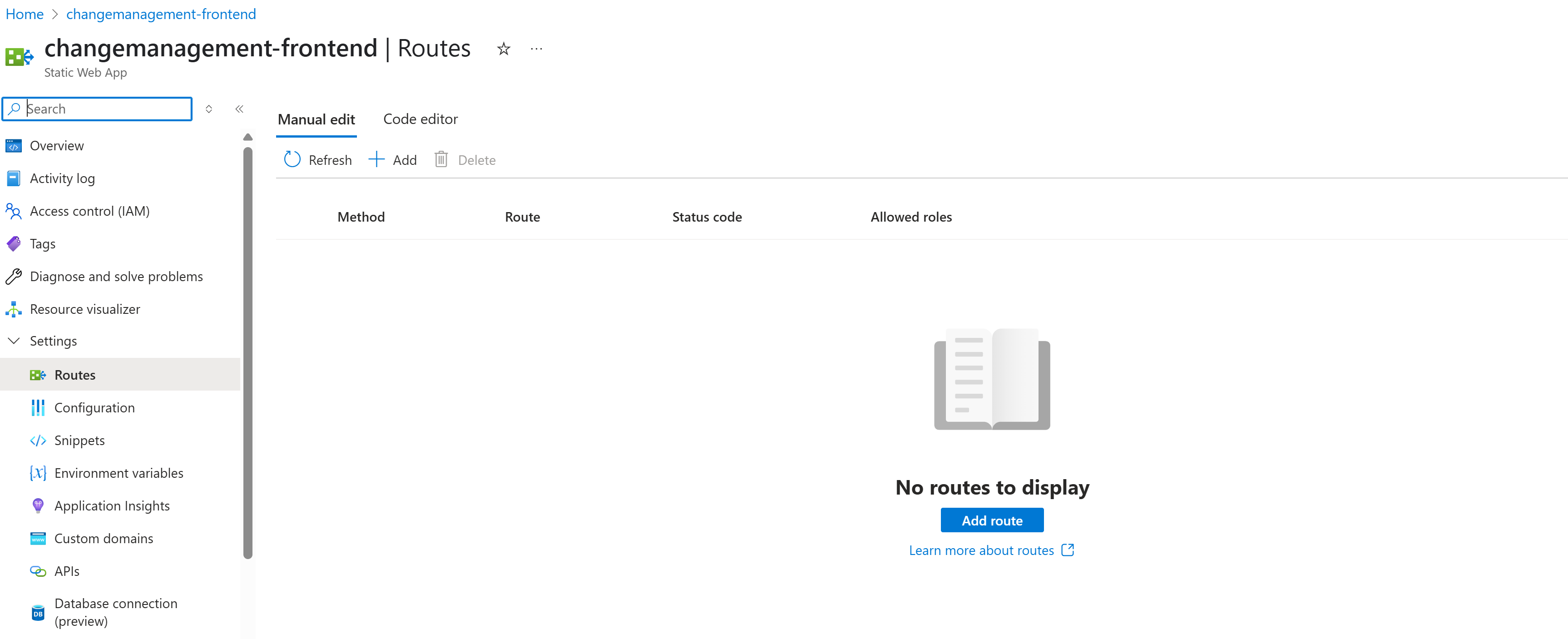

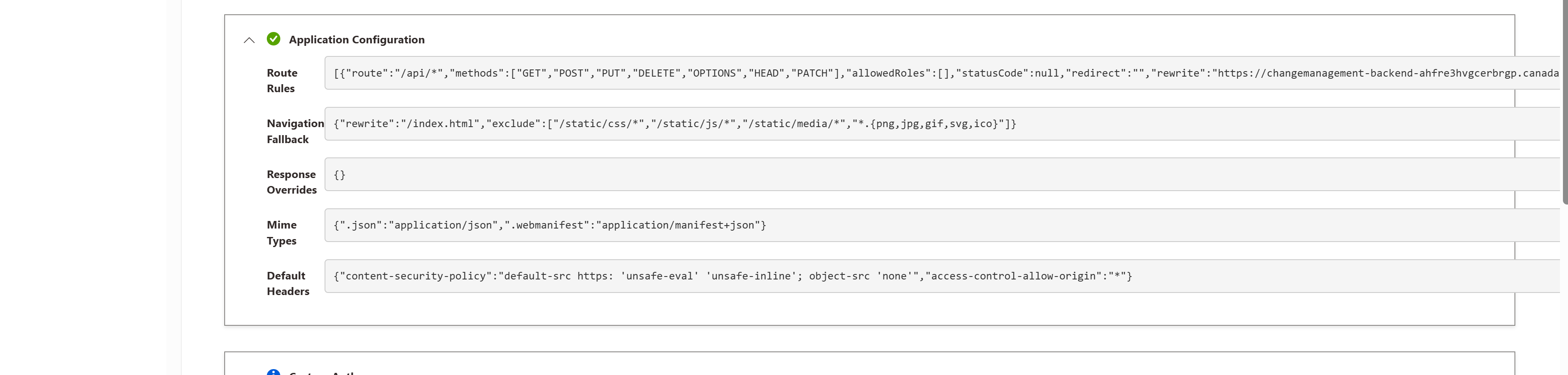

The SWA "Application Configuration" view in the portal shows that it has parsed the rewrite rule correctly. However, when the frontend (served by SWA) makes a POST request to /api/auth/login, SWA returns a 405 Method Not Allowed with an Allow: GET, HEAD, OPTIONS header, and the browser does not seem to be sending an OPTIONS preflight request.

    Inside that file, SWA expects you to use the word methods, not “allowedMethods.” If you write “allowedMethods,” SWA will act as if you only asked it to allow GET, HEAD, and OPTIONS, and it will reject POST. You also must use a placeholder called {*restOfPath} so that SWA knows to take whatever comes after /api/ and append it to the backend URL exactly. If you use any other placeholder, SWA won’t match the rule at all, and you’ll still see “No routes to display” in the portal.
    A simple, correct staticwebapp.config.json might look like this check below.
      "routes": [
          "route": "/api/*",
          "methods": ["GET","POST","PUT","DELETE","OPTIONS","HEAD","PATCH"],
          "rewrite": "https://changemanagement-backend-ahfre3hvgcerbrgp.canadacentral-01.azurewebsites.net/api/{*restOfPath}"

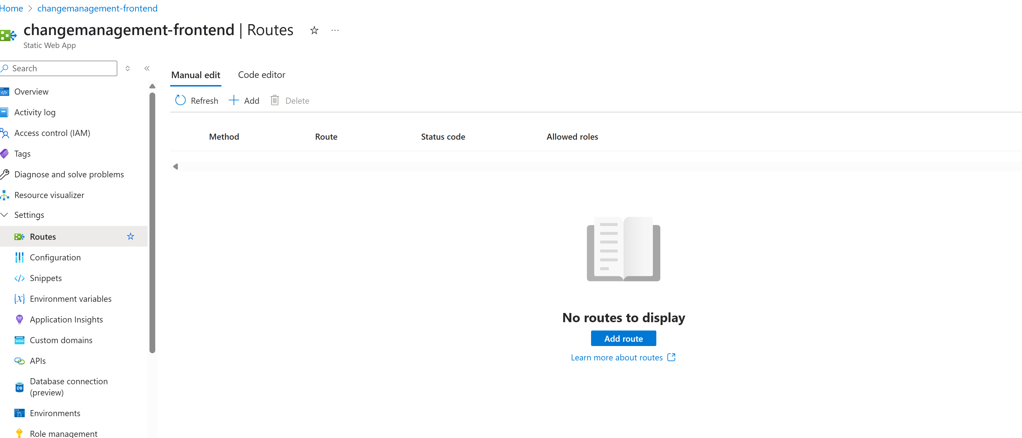

    After you save and push that file, wait for your SWA build to finish. Then check under Configuration < Route Rules in the Azure portal. You should see your /api/* rule with all the HTTP verbs listed. If it still says, “No routes,” SWA isn’t seeing your file, so you’ll need to double-check where you placed it.
