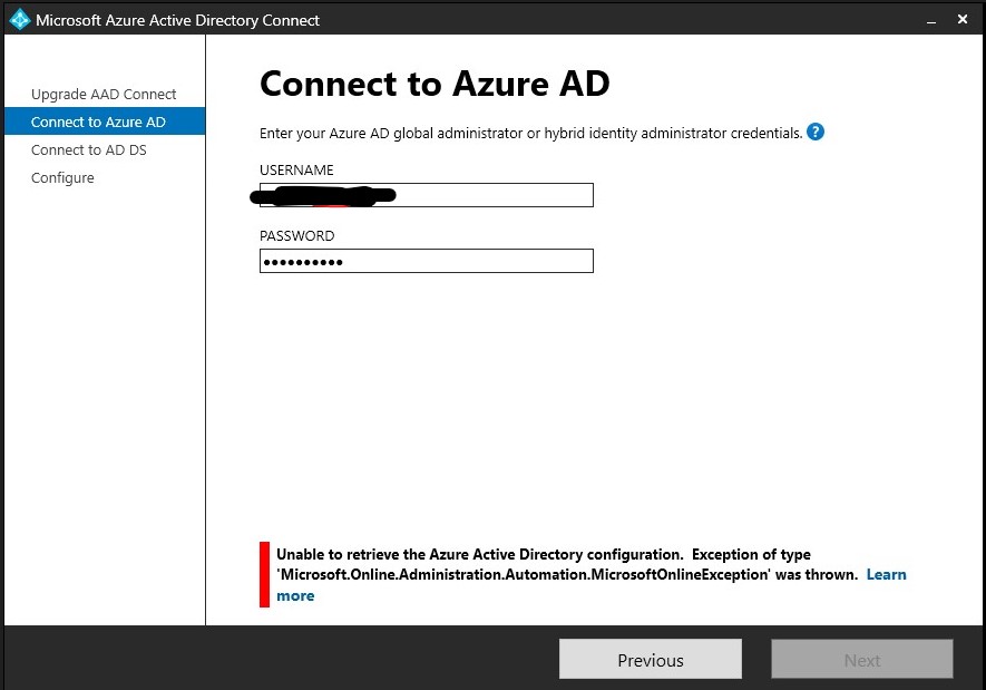

We are currently using an older version of Azure AD Connect (v2.2.8.0) in our hybrid environment. Since we rarely make changes to the synchronization configuration, we haven't accessed Azure AD Connect in a long time. However, upon opening it recently, we were prompted to upgrade.
We attempted the upgrade but encountered an error after entering Global Admin credentials. We have verified that TLS 1.2 is enabled on the server.
Could you please assist us in resolving this issue? Any help would be appreciated.
Thank you.Screenshot 2025-05-31 132811

    The upgrade wizard fails after the Global Admin sign-in when it can’t establish a TLS 1.2 session with the Microsoft Entra endpoints. ✔️TLS 1.2 must be forced for .NET as well as the OS, and the box has to meet the new 2.4.x prerequisites.

    4 | If the wizard still fails
    Look in Event Viewer → Application for DirectorySynchronization or AADConnect errors.
    %ProgramData%\AADConnect\AADConnectUpgrade.log and %localappdata%\AADConnect\*.log show the exact stack trace.
    Post the first exception line here (strip tenant IDs) if you need more help.
    Give the registry edits a try, reboot, and rerun the MSI. 9 times out of 10 the sign-in step succeeds once .NET is locked to TLS 1.2. Let us know how it goes!
