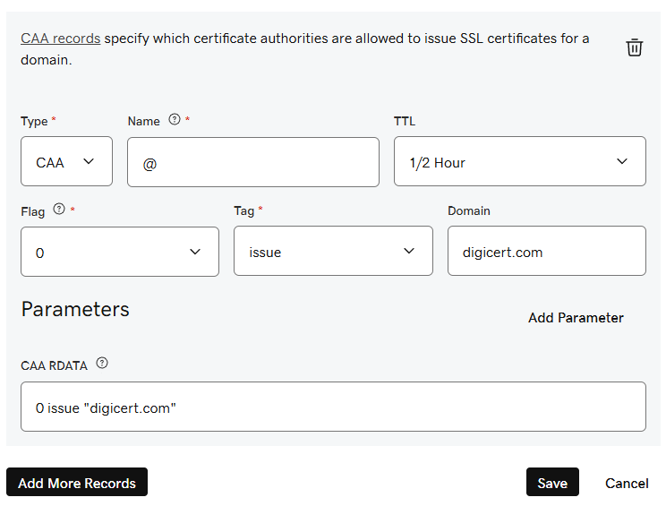

    Do you have CAA DNS record for your domain? If not I recommend you create it. It should be @ 0 issue "digicert.com" For example, if creating on GoDaddy it would look similar to below:

    You remove/re-add your custom domain by navigating to Custom domains blade. After re-adding domain, generating code, creating DNS TXT record, etc., it may take 10-15 minutes for it to say Validated and then some additional time for new certificate to be deployed out to endpoints.
    If you post your domain I could check if CAA record looks correct.
